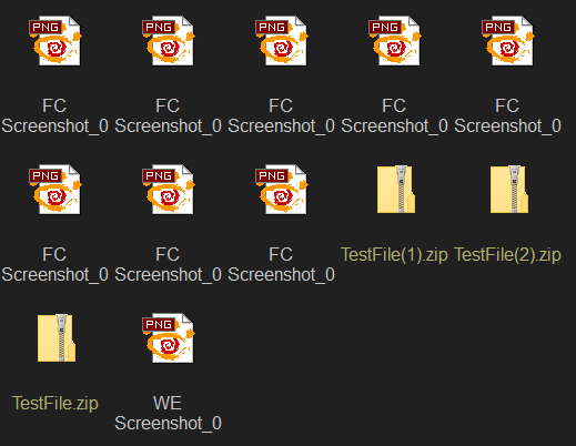

It's strange, I tried to remove some cache files, as it was in the link from you, thumbnails were not removed, then I used disk cleanup, removed thumbnails.
I just don't have any thumbnails now, in FC and WE.
In FC 840 old thumbnails are shown, just the new thumbs are missing.
In XnView all thubmnails are shown, old and new.
I can't restart PC now, I'll try it later...

After the PC restart:
840 - old and new thumbs are OK
8443+ - old and new thumbs are broken

I'm using just the Defender, tried to disable real time protection and cloud protection, still the same - moreover, I can't exit FC now, clicking the X does not work, no dialog, no freezing, had to kill it in task manager.
Then I tried to disable real time and cloud protection, start FC, old icons thumbnails were loaded instantly, new icons thumbs not leaded, then I enabled real time protection after a minute, don't want to be without protection too long.
I think that some other background operations are blocking active panel thumbs or columns loading.
After closing 4x fc exe in task manager, I started FC, no thumbs in both panels, few minutes, then I started XnView Classic, thumbs loaded instantly, started XnView MP, thumbs loaded instantly, same path, same icons. - In both XnView programs embedded thumbs and thumb cache was disabled before opening, so thumbs were loaded newly from files.
Strange thing is, that I opened recycle bin tab, I had columns, then switched to another tab and back and columns are missing, how is it possible? - I restarted FC and I have the columns in recycle bin - tab switch and no columns again.
