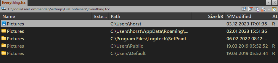

Re: Folder List built with a script
You make the error to not showing the path in your FC display.
I use the Search columns profile for the container view.
That's the result shown for searching all folders with the name pictures. The path is displayed, so it's clear what every name means.
The file container content is
#FreeCommander file cart
C:\Program Files\Logitech\SetPointP\BTWizard\Pictures
C:\Users\Admin\Pictures
C:\Users\Default\Pictures
C:\Users\horst\Pictures
C:\Users\horst\AppData\Roaming\MyPhoneExplorer\samsung SM-G991B [99DA8397-7528-477B-A944-7A0709561D47]\ThumbnailCache\sdcard\Pictures
C:\Users\Monika\Pictures
C:\Users\Public\Pictures
C:\Windows\ServiceProfiles\LocalService\Pictures
C:\Windows\ServiceProfiles\NetworkService\Pictures
