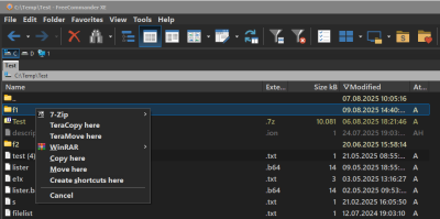

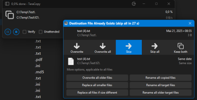

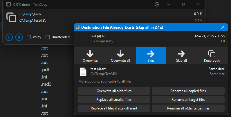

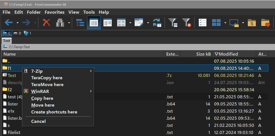

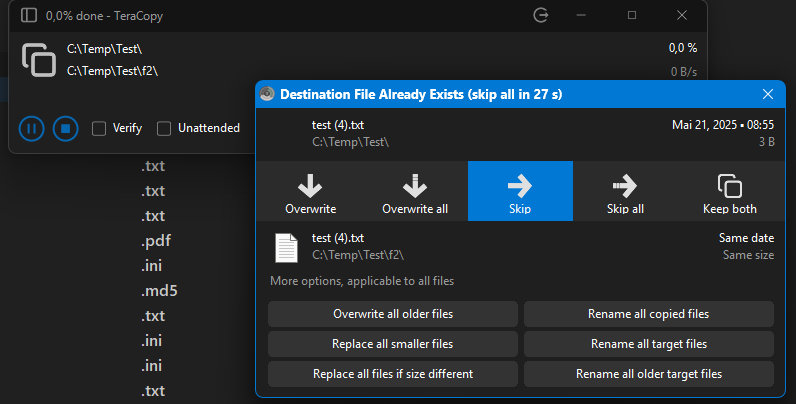

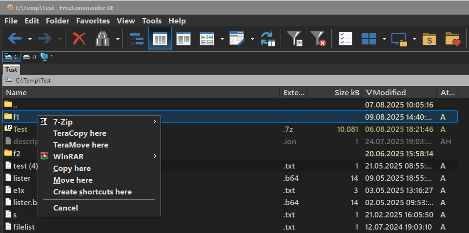

For me, it works when I start the drag operation on the icons of the selected file(s).coyote wrote: 27.06.2025, 02:06 Not only does TeraCopy continue to not work for me with drag-and-drop on "FreeCommander XE 2025 Build 933 64-bit donor" (while TeraCopy still does work with my Win11 64-bit 24H2 File Manager)...
Now when I forget and do a drag-and-drop with FC, the Windows dialog box doesn't even appear (making it impossible to know when the operation completes).
This situation is very inconvenient; will it be fixed please?
I then get the menu and can select to move or copy.
For collisions, I can see that FC is used in this case and not TeraCopy.
The normal Copy/Move buttons are all working fine, using TeraCopy.

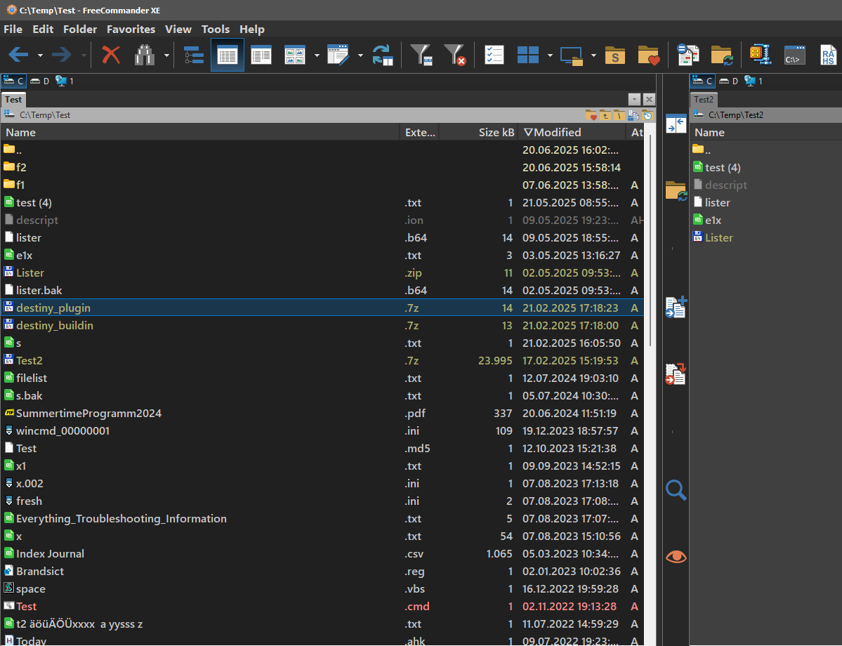

The buttons are between the 2 Windows.coyote wrote: 27.06.2025, 17:24 But in the meantime (while I want to drag-and-drop), where/what are the Copy/Move buttons are you talking about?
FC changes the arrows on it depending on the current active side.
I always use the buttons, never drag and drop.
It's much faster to click and one of the reasons to have a 2 windows file manager.
This is how it looks

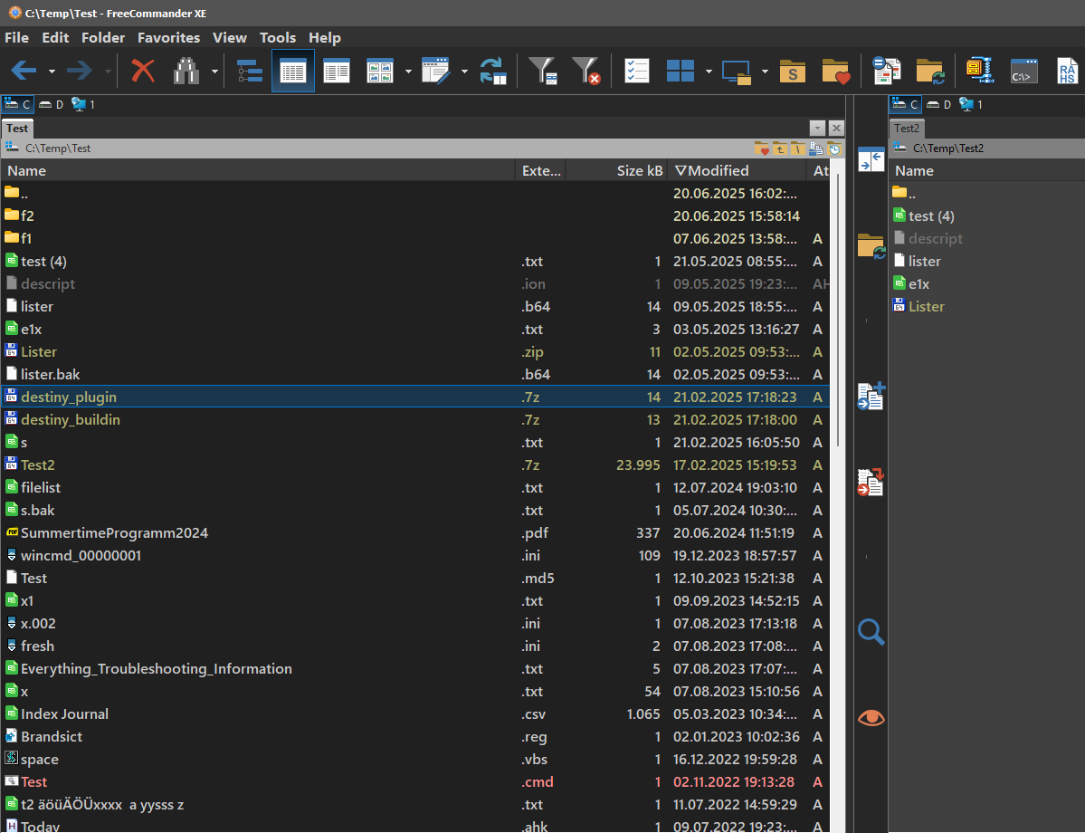

I installed current version 3.17 of the TeraCopy in the VM for testing and i really do not know what is your problem.
For me all works fine.
Send me your FreeCommander settings files and describe which operation does not work for you.
