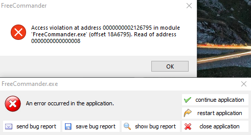

#5 (exception)
- use default options
- use NC mode
- select 3 png files
- Ctrl+P
- enable "Use current folder" option
- click the button "Queue"
= Result - dialog is closed, but jpg files are not created
- now select 3 png files again
- Ctrl+P
- add transformation "Resize", default values, 800x600
= Result - file list is not refreshed
- Ctrl+R to refresh file list
- press X to close FC
= Result - Access Violation error dialog + Exception dialog
- select "Restart application"
= Result - first jpg file is created correctly, but not the others

Posts: 4444
Re: 950 - Batch image transformations broken + exception
#3 Post by Marek » 20.06.2026, 12:11
The main problem is: the "Queue" button should be not active if no transformation step is defined - fixed for the next release.
