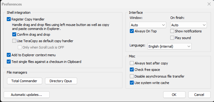

Re: Make CTRL + X / V keyboard shortcut use FC instead of Windows' manager
I had the same settings and it did not work
But after selecting
TeraCopy > Preferences > Shell integration > Use TeraCopy as default copy handler
it works now almost OK. Because I have no issue with files being handled with keyboard shortcuts in all possible ways - but if I CTRL+C on a folder and then CTRL+V in the same location then I do get its copy, but TeraCopy produces a window informing me [in Log] about 1 verification error for every copied folder [despite actually creating perfect copies and with their contents]. And thus I am forced to manually close window with useless information
But that is something I should pick up with TeraCopy developers, as it also happens in Windows Explorer?
But after selecting

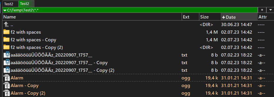

These problems don't occur here using TeraCopy version 3.9.7Forez wrote: 02.07.2023, 12:24 I had the same settings and it did not work
But after selecting
it works now almost OK. Because I have no issue with files being handled with keyboard shortcuts in all possible ways - but if I CTRL+C on a folder and thenCTRL+V in the same location then I do get its copy, but TeraCopy produces a window informing me [in Log] about 1 verification error for every copied folder [despite actually creating perfect copies and with their contents]. And thus I am forced to manually close window with useless information
It creates the duplicate entries adding Copy, Copy (2) and so on.
For me the same error happens also in Build 891 32-bit Donor installed. Uninstalling and installing once more TeraCopy 3.9.7 also did not helo
Could you please select
TeraCopy > Preferences > Misc > Always test after copy
and the execute on some folder CTRL+C and the CTRL+V to see if you get an error or not?
Yes, with these settings it produces verification errors.Forez wrote: 03.07.2023, 10:47 For me the same error happens also in Build 891 32-bit Donor installed. Uninstalling and installing once more TeraCopy 3.9.7 also did not helo

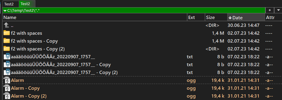

It looks like this.
Nevertheless, I'll not enable the verify option.
The copies are always ok.
I use TeraCopy seldom,
more often FastCopy, as it is able to copy symlinks unchanged.
Both are configured as buttons in Total Commander and Free Commander.
For normal file operations, I always use the native functions of any file manager.

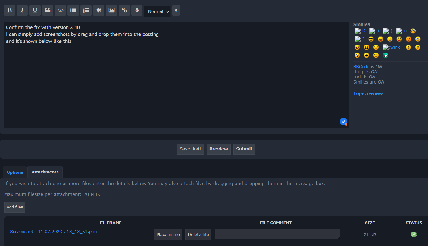

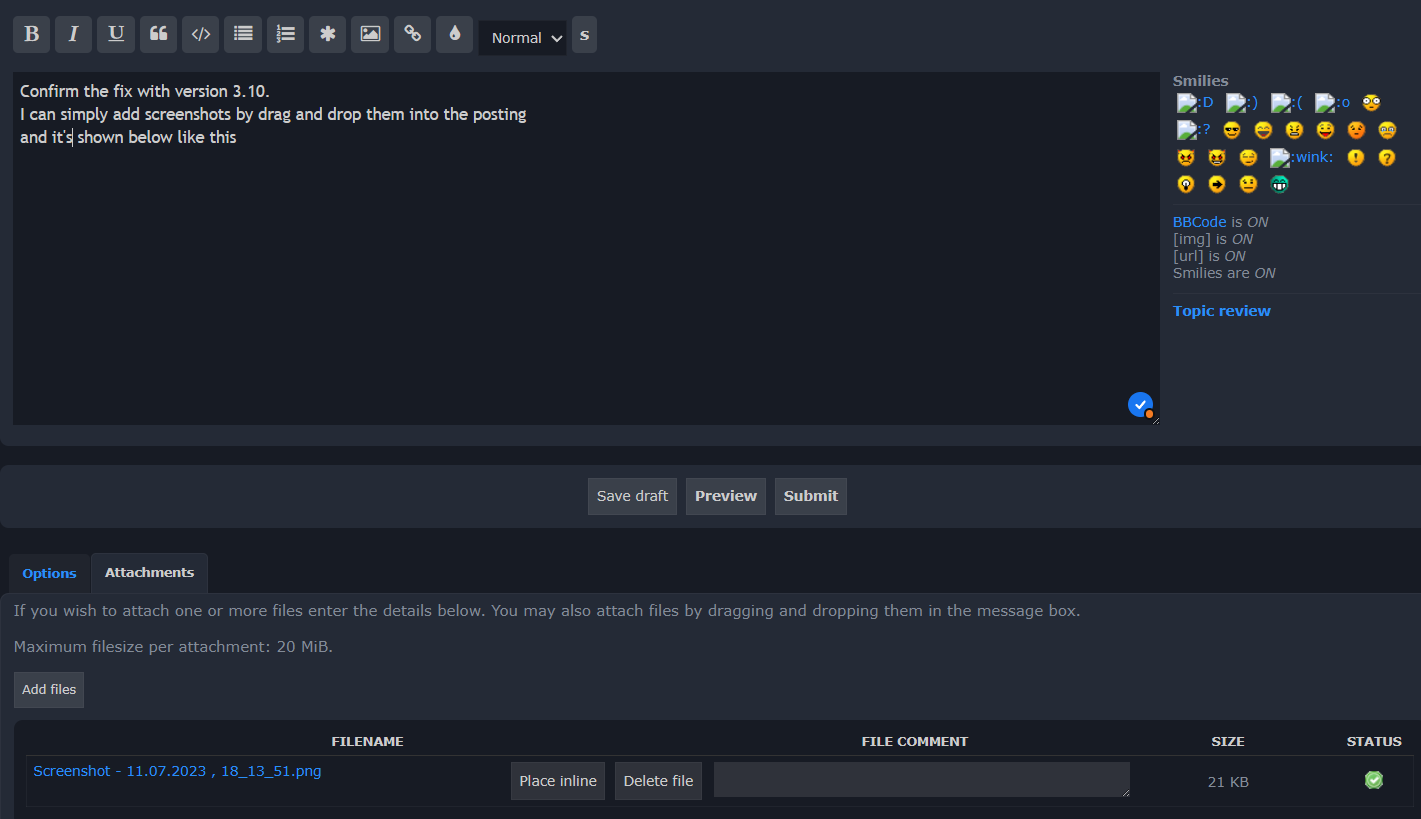

Confirm the fix with version 3.10.
I can simply add screenshots by drag and drop them into the posting
and it's shown below like this
