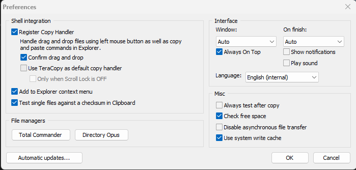

To have TeraCopy for the Explorer like copy/cut/paste functions and drag and drop
you must register the TeraCopy Copy handler.
You may also make it the default system-wide copy handler.

I had the same settings and it did not work
But after selecting
TeraCopy > Preferences > Shell integration > Use TeraCopy as default copy handler
it works now almost OK. Because I have no issue with files being handled with keyboard shortcuts in all possible ways - but if I CTRL+C on a folder and then CTRL+V in the same location then I do get its copy, but TeraCopy produces a window informing me [in Log] about 1 verification error for every copied folder [despite actually creating perfect copies and with their contents]. And thus I am forced to manually close window with useless information
But that is something I should pick up with TeraCopy developers, as it also happens in Windows Explorer?

For me the same error happens also in Build 891 32-bit Donor installed. Uninstalling and installing once more TeraCopy 3.9.7 also did not helo
Could you please select
TeraCopy > Preferences > Misc > Always test after copy
and the execute on some folder CTRL+C and the CTRL+V to see if you get an error or not?

Yes, with these settings it produces verification errors.
