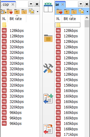

- in details view add just 2 columns, Name and Bit rate
- go to folder with mp3 files with different bit rate, one song need to have bit rate 96kbps, or between 40 - 99
- click the column header for Bit rate, to sort by bit rate
- in Settings > View > File/folder list > Sorting > use "Alphabetical - string sort" (or "word sort")
= sorting is wrong, with bit rate between 40 - 99 kbps only (and probably with any bit rate below 100)
FC 806 donor, Windows 10 1909.

Not fixed in 807. I had Data type set to "text" before too, now I tried to set to "number", then back to "text", but sorting is wrong each time.
EDIT: OK, so with "number" option the sorting is like random:
96
320
128
320
320
96
320
So it's sorted by Name, even if "Bit rate" is used.

If the data type of the column "Bit rate" is set to text and you use the option "Alphabetical - string sort" for sorting, then the sorting on your picture is correctly and was not changed.
If you want to sort the column by bit rate value (by "Alphabetical - string sort") - you need to change the data type to number.
Works fine here. In my "Bit rate" column I have values as:
48 kBit/s
64 kBit/s

Hm.. OK, but it doesn't work good even with the option "Number", with default settings, I clicked Apply, switched to list and back to details view, I tried also FC restart, still the same.
