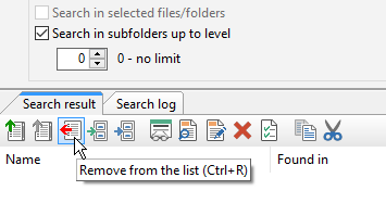

Here is the screenshot from 830 public beta:
