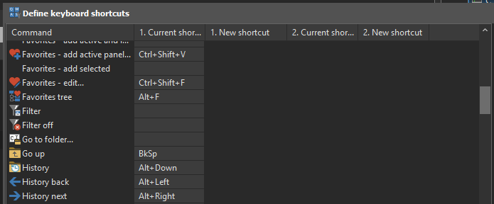

by horst.epp
sfgs97 wrote: 04.01.2025, 18:00 ...
Unless you've found some way to modify the default behavior in FreeCommander then it is definitely not the default. I posted in this topic because the
The Backspace key does by default what I said,
it goes up one level in the file system, in the actual x64 FC.
The key is shown in the "Define keyboard shortcuts"
Command 1. Current shortcut
Go up BkSp
Screenshot - 06.01.2025 , 17_12_33.png (15.93 KiB) Viewed 228807 times
