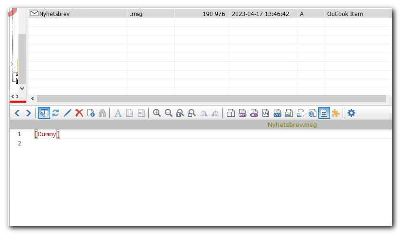

Preview of Outlook email files (msg) doesn't - work (as it should) in FreeCommander anymore.
At least not on this PC...
First part of all email is displaying / substituted with:
1 [Dummy]
2
... and lots of with space
as this:
Screenshot - 2023-04-17 x 13_47_35.png (22.55 KiB) Viewed 95269 times
Preview works fine i ms explorer

Tried to run FreeCommander XE as Admin, - then preview of msg-files works.
So it's probably some security settings on my PC that have changed, - but then preview still works in explorer somehow....

Found the source of the problem: custom preview handler in MS Power Toys.
The solution:
Turn off preview handler for "source code files" and then , somehow, MSG previews as normal.
