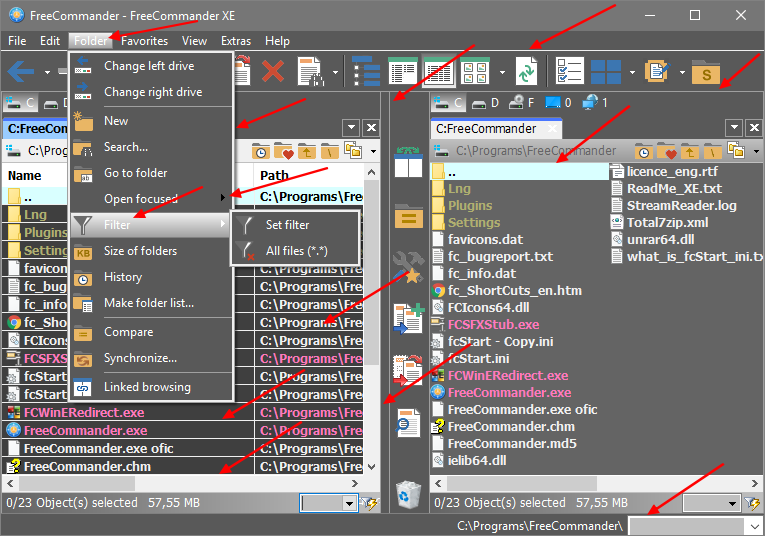

Marek, thank You again for the color schemas feature, it's really useful and it will be easier to share.
There are some known issues with dark colors though and I found some new, I have also few personal suggestions.
Issues/suggestions for color schema:
- how to change main menu background and text color? It's different in Dark_Gray_Flat schema, but how to change it?
- is it possible to remove the white line right below the main menu, or at least make it thinner, same as others?
- is it possible to remove other thin white lines, or change the color of these lines?
- some white lines and borders (in menu, CMD) are too heavy, is it possible to make it thinner?
- color of scroll-bars and details view headers can't be changed, old issue
- gridlines are too bright, color can't be changed, old issue

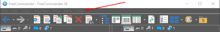

Issues/suggestions for Dark_Gray_Flat schema:
- selected menu item text is hard readable (white on light grey)
- black arrows on grey background in menu
- I don't like the aqua color inactive panel, active item, what about very light blue?
- I don't like the pink color for exe files, it's also too similar to red color for selected items in NC-mode
- white color for text in panels is too bright, what about a bit darker color, not too much
- main menu text is almost unreadable if main FC window is inactive
- context menu checkboxes (v) are missing, only empty squares are visible

Re: Color schemas - cosmetic issues, suggestions
Thanks for your suggestions.
Currently I am not able to change the color (or size) some elements:
- gridlines
- columns header
- scrollbars
- the line below main menu
Main menu color: "Tools->View style->Gradient - Custom" the "Gradient stop" color is used for menu and the "Font" color for menu text color.
With the "Border color" in the "Custom style" dialog you can change the color of the borders (" other thin white lines").
Thanks for the suggestion to Dark_Gray_Flat schema. If it is possible try to make your changes and send me your file so I can check it.
- gridlines
- columns header
- scrollbars

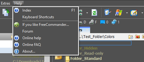

I'm trying to create gray-only color schema. Is it possible to change the blue color / lines for some buttons and for selection in address bar, rename dialog...?
Blue color from the buttons is now fixed.

New issue, some icons (non-flat) doesn't look good on dark background, could you edit these icons, cut the edges, somehow?
