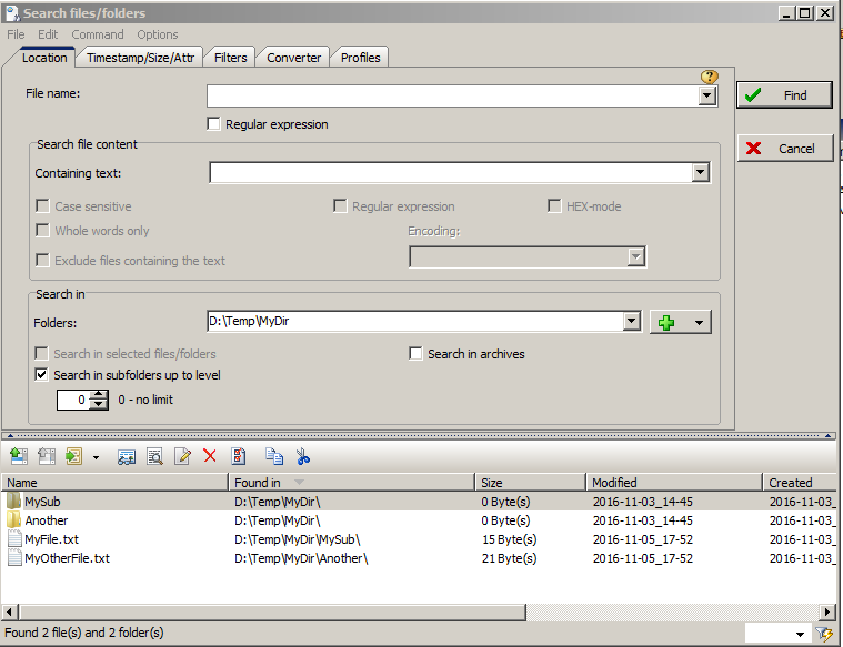

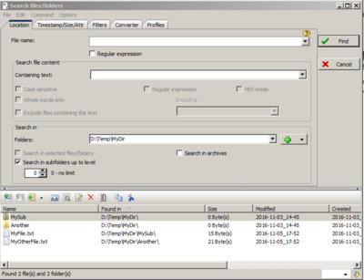

Case is quite simple, two files in subdirs of MyDir (can't upload zip files in this forum apparently nor unknown extensions nor fake image) :
D:\Temp\Mydir\MySub\MyFile.txt
D:\Temp\Mydir\Another\MyOtherFile.txt
(I used FC search at location D:\Temp\Mydir without parameters to get the above plus the two sub-folders) :
I would like to filter on path with substring "Sub" to find "MyFile.txt" or "Anot" to find "MyOtherFile.txt"

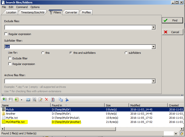

N.B. : I think there is some kind of persistance in the resultset because I have had unrepeatable results sometimes.

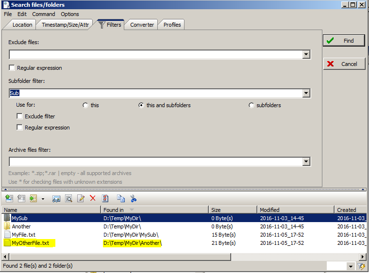

1/ filter "Sub" (without jockers)
Bring everything (doesn't filter anything) :
So I guess jockers are needed but I would expect in this case that neither files nor directories would show up in the resultset

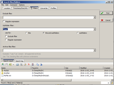

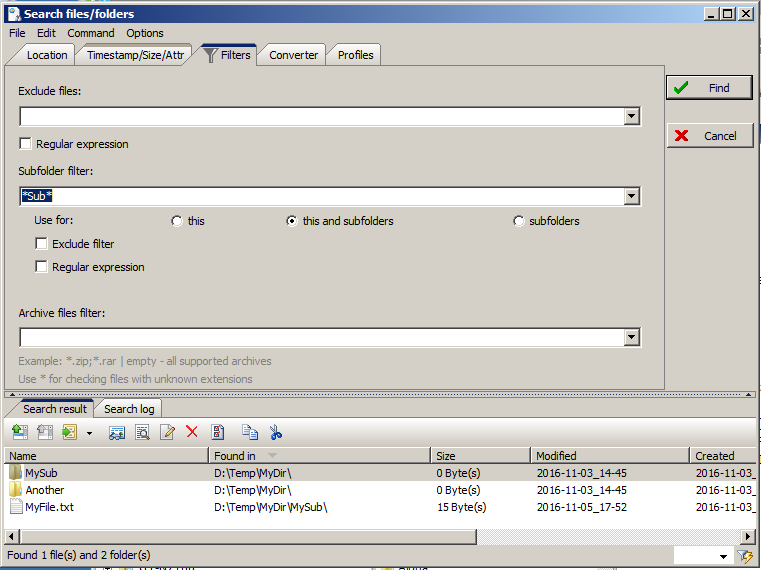

2/ filter "*Sub*"
Seems to bring the expected result :
BUT weirdly, I have to click twice on Find from a restarted FC otherwise, I still had the previous result

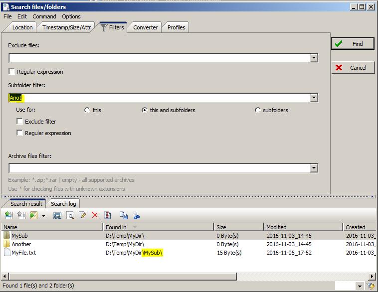

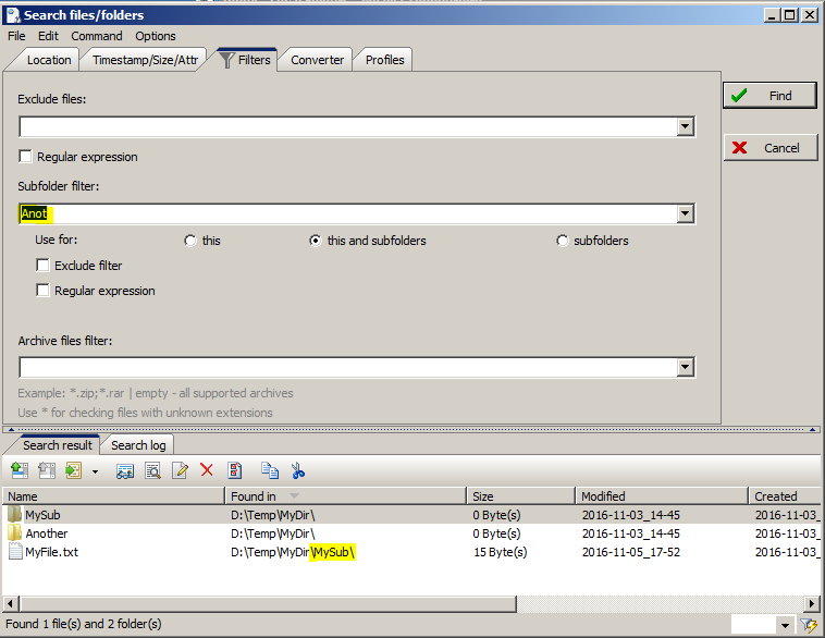

3/ filter "Anot"
Persistence again : my resultset doesn't change rather than filtering like expected (or filtering out everything)
n.b. "Anot*" will filter as expected

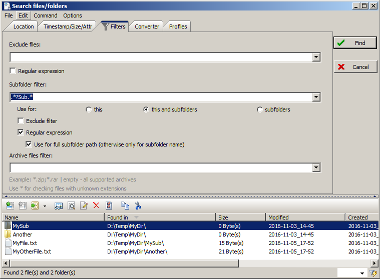

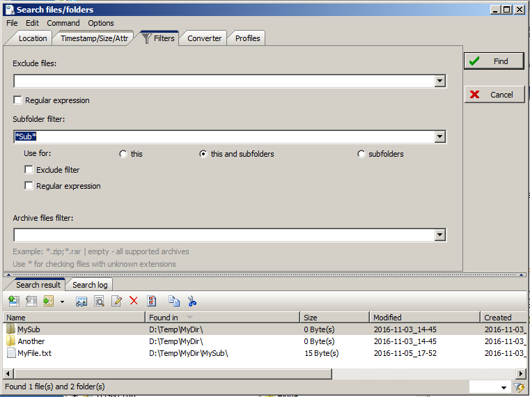

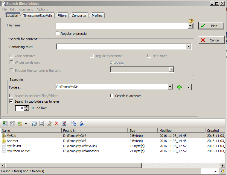

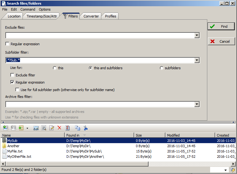

4/ regex filter ".*?Sub.*" (ungreedy before Sub)
won't do either on folder name :
or full path :
"Sub" alone (which is an acceptable regex ?) won't filter any better
