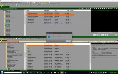

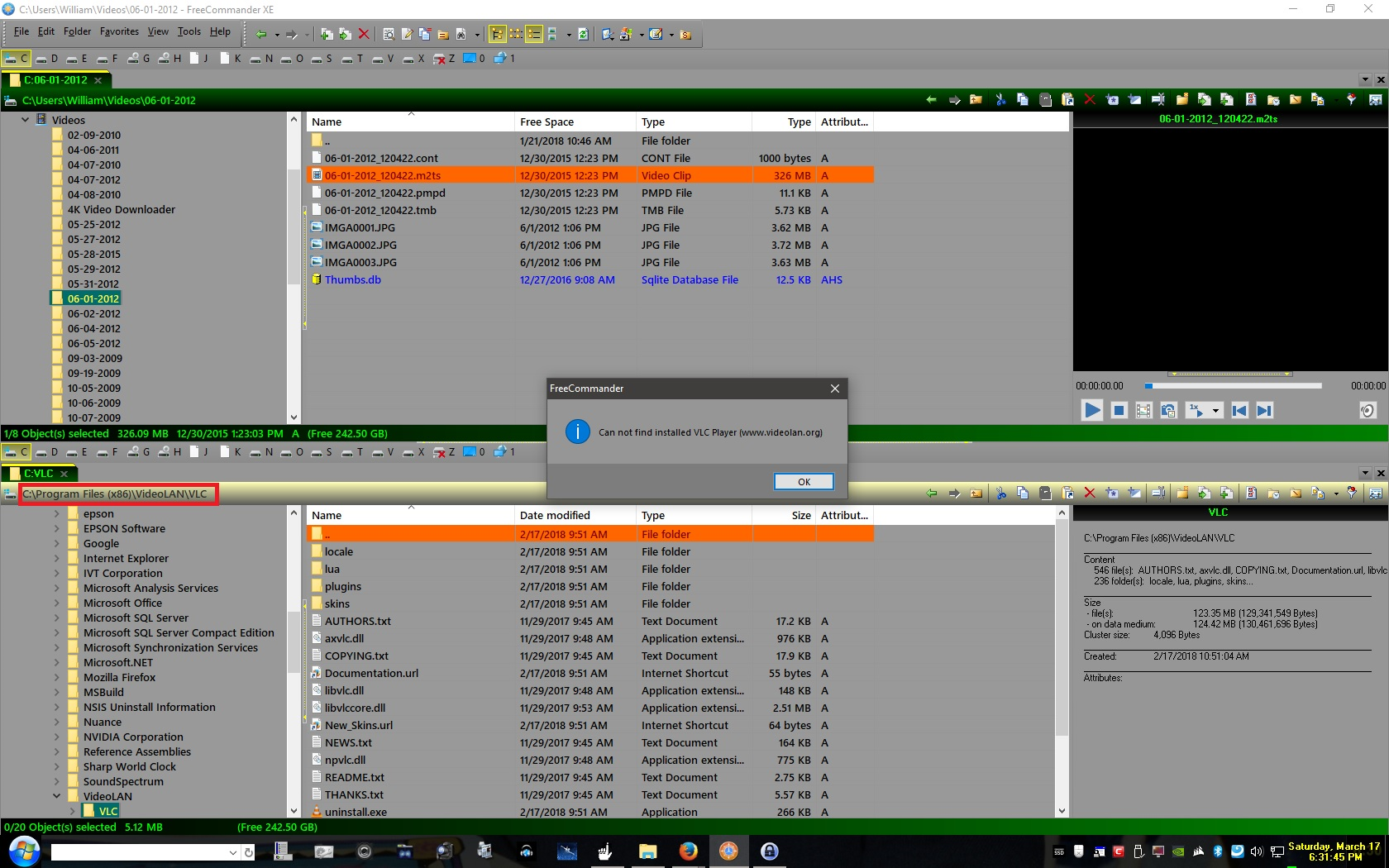

This has not been working for a while now. In settings-->view-->viewer if I click on viewer or quick viewer, go to the multimedia tab and try to set vlc as the media interface, it doesn't work.
When I try to view a file, I get the message "Can not find installed VLC Player (www.videolan.org) It is installed in the default location.
Re: VLC Media Interface
#2 Post by Karol » 18.03.2018, 10:02
For 64 Bit FreeCommander you need to install 64 Bit VLC Player.
