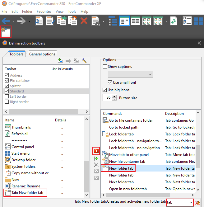

Thank you for clarifying this. I've only customized the Standard Bar to have my own collection of useful buttons, and didn't really ever seek out anything more than that.
But I probably didn't pursue it much once I saw that these buttons are placed on the right-end of the bar (and since I am top/bottom the bars are horizontal, and they are very wide so that to get the mouse over there to click on a button represents a huge amount of cursor motion).
Nevertheless, I tried to see what it would look like if I added "open in new folder tab" to the Address Bar. I followed your directions, and got as far as the following:
I don't follow the documentation, regarding how to set an icon for this button. This is what it says is supposed to appear when I click on the ".." value in the details column for the new row I just added for the "open in new folder tab" command:
When I click on the ".." in the details field I do not get the popup window shown in the documentation. Instead I get the popup window shown in my screenshot above, which is for a "separator" which is what gets added when I push the "add" button having selected the "open in new folder tab" command.
What am I missing about getting an icon established for this command?

There are more "New folder tab" items in the list, one of them has the icon, at least in the latest public beta - 830.

Re: Feature request: right-click menu on Address Bar offers "new folder tab"
I had used "open" in the filter box as instructed. This other "new folder tab" did not show up. I've now found it using "tab" in the filter box as you've done. And yes, the command does appear to have an icon associated with it.Dreamer wrote: 08.11.2020, 13:53 There are more "New folder tab" items in the list, one of them has the icon, at least in the latest public beta - 830.
However adding that command still causes the "separator" to appear in the items/details pane. And once again, clicking on the ".." in the details cell still produces the separator popup dialog, not the real command one which supports specifying an icon.
I don't understand that toolbar button issue, just double click "New folder tab" and then OK, no need to click to [..] item at all.
Why you're running FC as admin? It's not needed for normal usage, not even recommended.

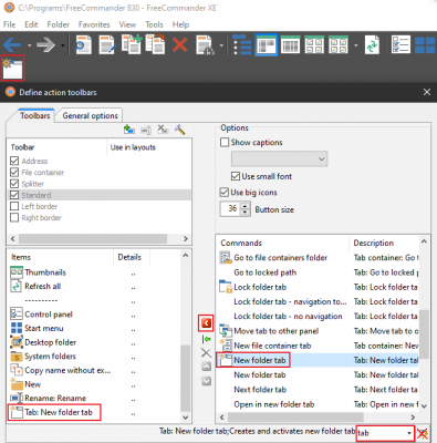

Ok. My bad. The font is so small at my screen resolution of 2560x1440 and I'm so tired that I've been pushing the wrong button to add the command. My eyes and brain processed the "green arrow pointing left" as the button to be pushed. But of course it's "insert separator". What I should have been pushing is the button above it, the "red arrow pointing left" which is "insert command". Unbelievable.
Anyway, I'm straightened out now. I have gotten the actual command added, rather than a separator. And as you point out it can also be added by double-clicking. Or, as was clearly intended, select the command and then push the red arrow button at the top to "insert command". And either way it gets added to the left side.
However there appears to be a bug in FCXE adding that command. Whether using the red arrow button or double-click method, when I select the command row that has the icon and use either of the two methods for adding the command, the row selected drops down from the first of the two rows for "new folder tab" (which is the one with the icon) to the second row where there is a second "new folder tab" command but this one without an icon. And the actual command that gets added and appears on the left DOES NOT HAVE AN ICON!
Furthermore, when clicking on the ".." in the just-added command for "new folder tab", the dialog window that comes up doesn't seem to have anything in it. How am I supposed to use this??
But the real problem is that the first command WITH THE ICON SHOWING did not get added. For some reason, when double-clicking on the selected row (i.e. the first "new folder tab" row which has an icon) the selection drops down one line, to the second "new folder tab" command that doesn't have an icon. And that's also what gets added, i.e. no icon.
You're right, the command "new folder tab" with the icon doesn't show the icon when it is added to the toolbar.dsperber wrote: 09.11.2020, 12:51 However there appears to be a bug in FCXE adding that command. Whether using the red arrow button or double-click method, when I select the command row that has the icon and use either of the two methods for adding the command, the row selected drops down from the first of the two rows for "new folder tab" (which is the one with the icon) to the second row where there is a second "new folder tab" command but this one without an icon. And the actual command that gets added and appears on the left DOES NOT HAVE AN ICON!
This is a pitty, but what's about adding an own icon? If you don't have icons, you can find some "new tab" icons here:
https://findicons.com/search/new-tab
I don't know where the FC-Icon are saved. I thought in FCIcons64.dll or FCIcons.dll but I couldn't open them to extract some icons.

This is a known bug, icon is not shown in that dialog (it's for any option), but it should appear on toolbar, as I said, try this:ralfso wrote: 09.11.2020, 16:19You're right, the command "new folder tab" with the icon doesn't show the icon when it is added to the toolbar.
When you re-open the dialog, icon should be shown also in that dialog. Re-tested again in 830 public beta and 832 donor.
