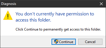

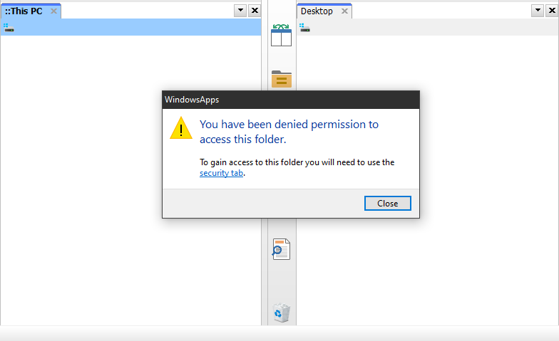

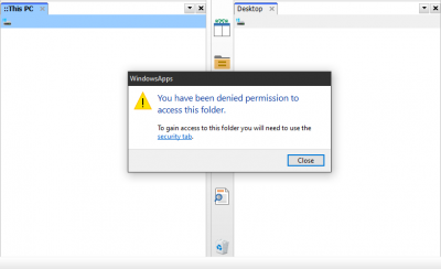

OK, I tried it with default settings and I can confirm it, with multiple error dialogs and freezing.
- plug any flash drive or external USB disk
- use plain view, ctrl+b
- close FC
- unplug flash drive
- start FC
= multiple dialogs are shown, when I close them all, FC is freezing and more dialogs are shown, both panels are empty, after 10 minutes FC is frozen, not responding
It doesn't matter if I click continue or cancel, I tried it again and I have more than 30 dialogs already.
When I try to use ctrl+b on This PC path, dialog is shown - "Operation is not supported", so FC should not try to use it, so now I think it is a bug.
