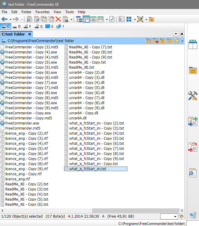

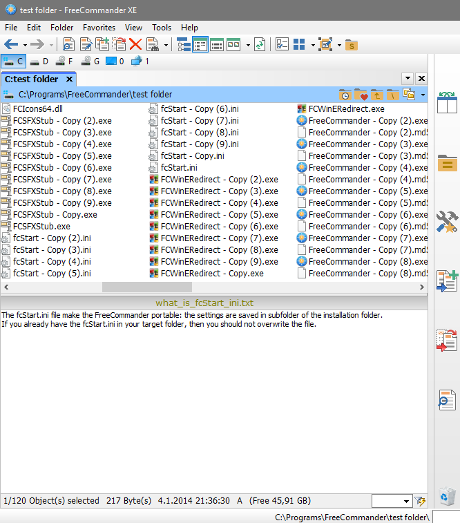

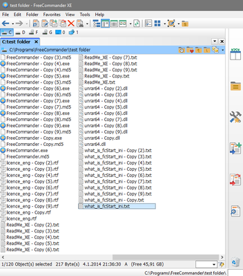

Re: Delete last item - wrong column focused
Got it.
- don't use viewer's option "use the opposite panel" (you need to click "Apply" button)
- go to any folder with many items
- press ctrl+q
- make the quick viewer larger, about 50%
- press ctrl+q to close quick viewer
- focus the last item
- press ctrl+q
= wrong column is displayed, focused item is not visible
Same results when using the splitter bar quick viewer button instead of Ctrl+Q.
I still couldn't reproduce the problem when deleting the last item, but I think the problem is related, right item is focused, wrong column displayed, so perhaps fixing this issue could fix also the other one.

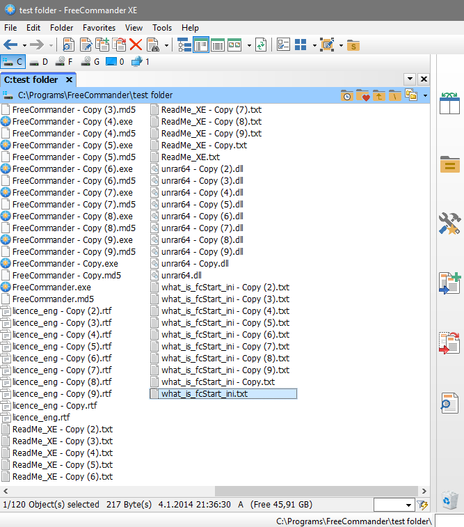

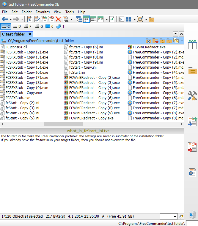

- press ctrl+q
- press ctrl+q
