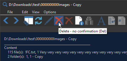

#9 Post by Dreamer » 08.06.2021, 22:22
In 848-1 test version it's still broken, [..] item, "Delete without confirmation" is not greyed-out.
fc 841 - Delete in internal viewer.png (19.51 KiB) Viewed 18802 times
Re: 841 - Delete in internal viewer
#10 Post by Marek » 11.06.2021, 22:44
Should be fixed now.
#11 Post by Dreamer » 11.06.2021, 23:09
It will be fixed in 849, fix confirmed, thanks, Marek.
