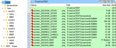

Re: File deletion issue
I downloaded the portable version, set up a similar file structure, tried to delete as before, and got the same error.
I've added a screen shot showing the file structure. In this case I'm trying to delete all .jpg files under the Temp Directory.
It finds them correctly but won't delete them.
There is a relatively easy workaround, so if few others are having this problem it may not be worth finding and fixing.
Once the files to be deleted are found (which works fine), I just copy them to an empty temp directory and delete them.

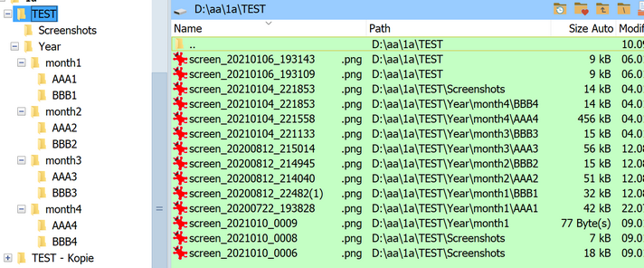

Here is the folder structure how I test it:
I can delete all files from the list without problem.
