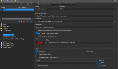

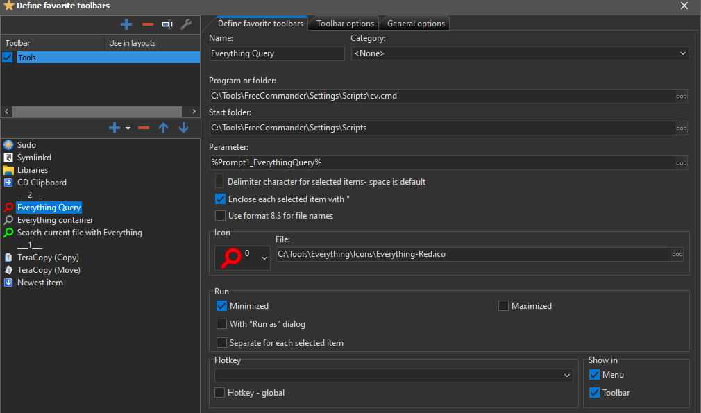

This is my version of it.
The code page change is required to support unicode characters using es.exe !
ev.cmd
chcp 65001
set file=C:\Tools\FreeCommander\Settings\FileContainers\Everything.fcc
echo #FreeCommander file cart>"%file%"
C:\Tools\Everything\es.exe %* >>"%file%"
The parameter for a favorite button which invokes the batch is
%Prompt1_EverythingQuery%
The Start folder should be the script dir.
Please note that using es.exe has many disadvantages compared to my Autohotkey script and the Everything GUI.
Many search strings will will not work with es.exe without escaping because they will trigger cmd functions.
The Autohotkey way has no such limitations and gives you also functions like bookmarks which are not available thru es.exe.
