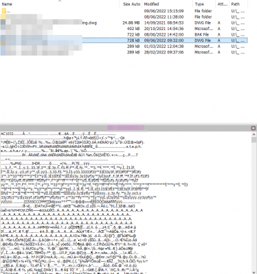

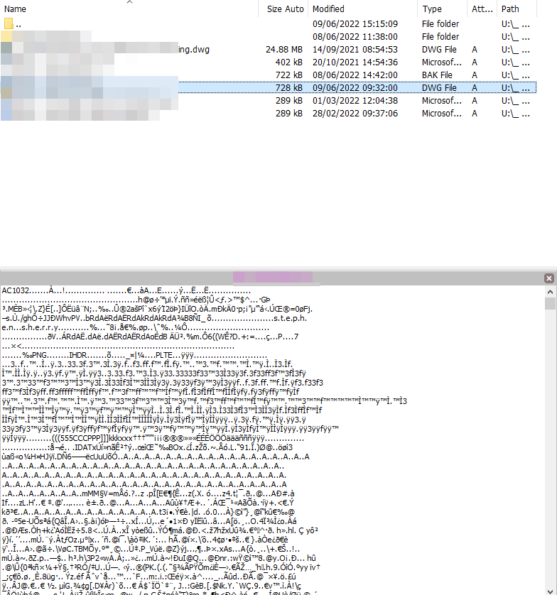

Thanks, horst.epp but this is what I've tried first.Karol wrote: 13.06.2022, 16:33 If you have already preview of the .dwg files in Windows Explorer then try to add the extension for .dwg in the viewer configuration ( tab "general", field "as Windows preview" ).
Thanks Karol, this works on my home PC where I have the paid-for version which is 869 but not the XE public version which I'm using at work which is 861.
I will probably wait until the version for the public one gets updated.
FC needs to be restarted in order for this to work.
