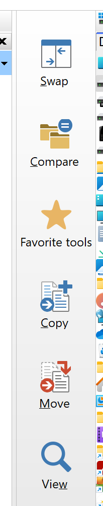

Probably confirmed, not sure if it's the same, to reproduce:
- in Define action toolbars, for Splitter use option "Show captions", "at the bottom"
- option "Use small font" can be enabled or disabled
= result is truncated captions and icons/buttons, even in maximized view and fullscreen mode
I tried to remove few buttons, resize window manually to max. height, still the same.
fc Screenshot_01212024_182553.png (13.88 KiB) Viewed 23563 times

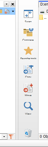

No problem here ("Use small font" disabled):
Of course you should adjust the button size.
