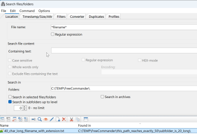

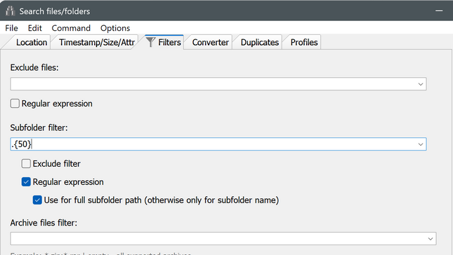

It used to work, it does no more (I can't tell on which build exactly this started to malfunction)

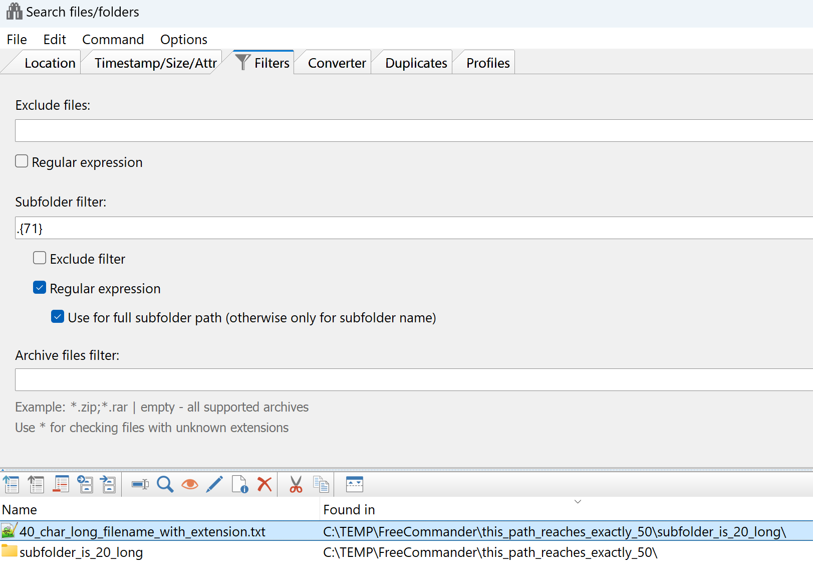

.{50} regex should bring all items whose fqn is 50 chars long but it doesn't (it seems checkbox is not taken into account and only subfolder name is filtered)
This feature is extremely useful to spot full paths larger than 260 chars (regexp = .{260,})

...also, it seems one now needs to add embed File name between wildcards/jokers (e.g. : *searched_filename*) as if implicitly, File name field should necessarily match the whole file or path string (it used to implicitly be a part of the whole string, ^ and $ markers in regex would allow to explicitly specify beginning and ending of line)

It seems to work for me for the following definition:.{50} regex should bring all items whose fqn is 50 chars long but it doesn't (it seems checkbox is not taken into account and only subfolder name is filtered)
Could you provide some screenshot with your search dialog, how do you define the search? (you can send me an email too)...also, it seems one now needs to add embed File name between wildcards/jokers (e.g. : *searched_filename*) as if implicitly, File name field should necessarily match the whole file or path string (it used to implicitly be a part of the whole string, ^ and $ markers in regex would allow to explicitly specify beginning and ending of line)

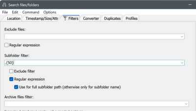

Hello Marek,
(a one-liner to get the chance to thank you once again for this incredible tool I'd die without)
I figured out there's no bug but most likely :

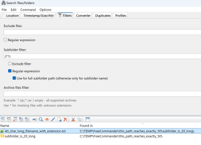

if I set my regex to .{72} it brings nothing as a result -> conforming to subfolder length, not fqn, all right, 'got that
any lower value like .{70} also returns my test set (contained a fortiori -> normal)

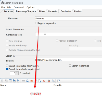

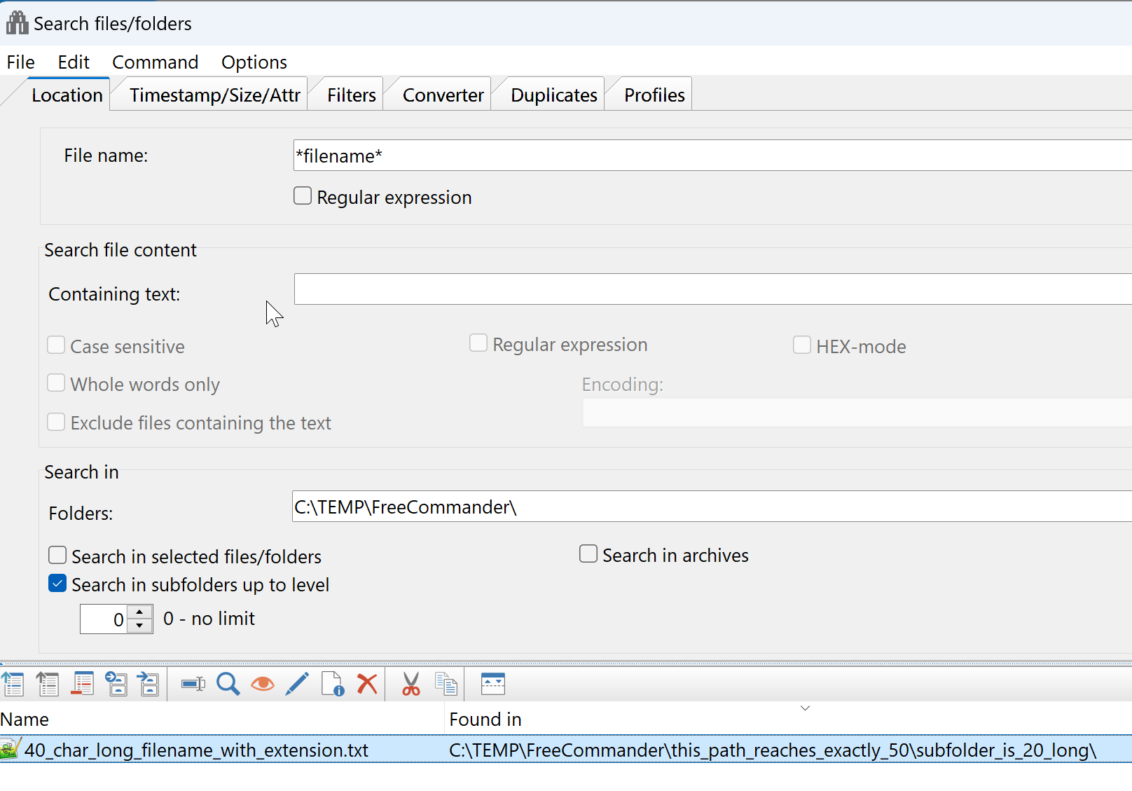

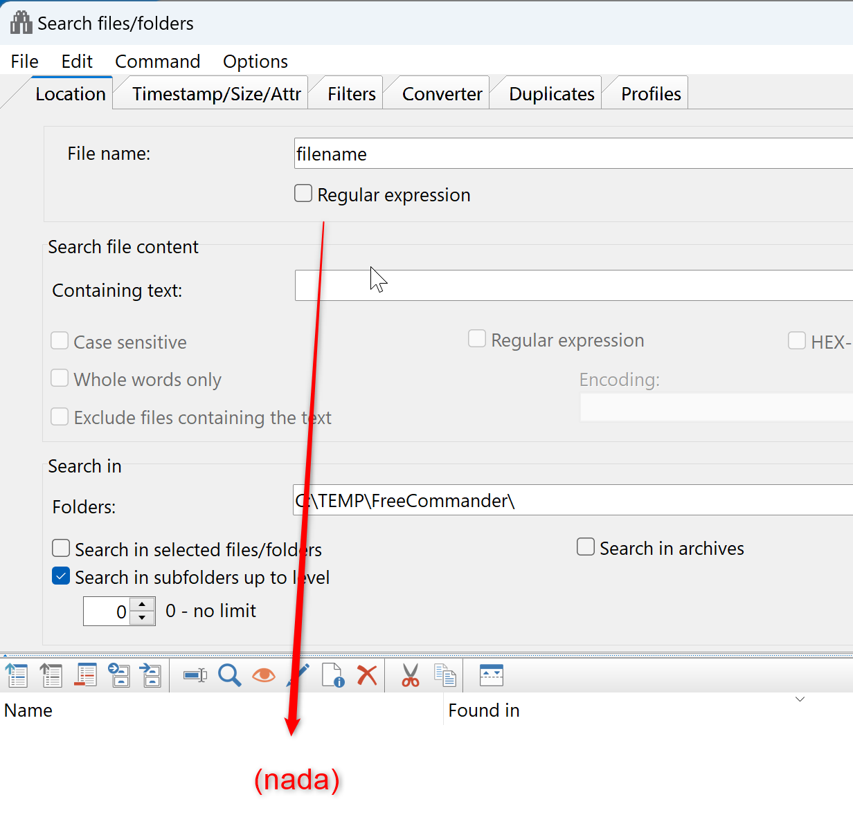

Conversely, with regular file search (i.e. : normal, no regex), I need to put wildcards if I want to match (whole line) : ...and without * wildcards, filename is not found: (I'm pretty sure it wasn't that way until recently as searching for a simple string in filename was just about dropping that string in search field)

In the search dialog please check the menu "Options->Add wildcards to file name" - this option is per default active.with regular file search (i.e. : normal, no regex), I need to put wildcards if I want to match (whole line) :
Re: [Build 925 64-bit donor] Search subfolder filter / regex / use full path NOK
bad bad me ! I know I should read the Fine Manual more often but, hasn't it changed along the course of revisions ?
Well, nice, I did alter my config and it now works fine like before ; thanks for your help.
