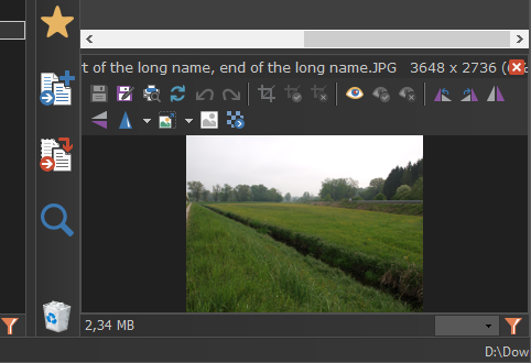

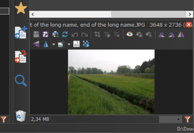

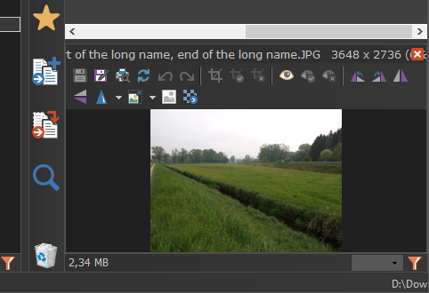

Name in the quick viewer is center-aligned, it should be left-aligned, because currently the name is not fully visible, if it's too long or/and the window is too small.
Test file name is "start of the long name, end of the long name.jpg", it's not fully visible on the screenshot.
Another issue - [x] close button is over the name.
If possible, the name should be left-aligned and shorten as in the file list, in this case, with the resolution and "%":
Currently it looks like this:
"t of the long name, end of the long name.jpg 3648 x 2736 ([x]%"
It should be like this:
"start of the long name, end of th....jpg 3648 x 2736 (6%) [x]"
The same issue is also in the viewer window, just it's not a real problem, because it's usually much larger than needed.

I can confirm that the name is center aligned.
I do not see this as a bug. If the panel is large enough, there is no issue for me.

#3 Post by Dreamer » 18.06.2025, 21:38
Fixed in 933, thanks, Marek.
