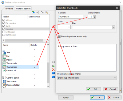

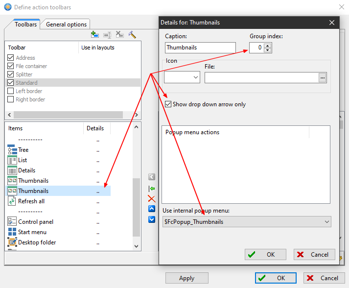

A user can add for the Splitter the Thumbnails command and change its settings by going to its Details
[Screenshot courtesy of Dreamer]
But if I choose and then Apply the Show drop down arrow only ticket box option, then nothing changes. It is only after I choose also from the Use internal popup menu drop-down bar e.g. $FcPopup_Thumbnails or lets say $FcPopup_FavoriteFolders that the icon on Splitter gains a micro arrow next to it - thus indicating ability for accessing under it a menu (created accordingly to that choice I made from that Use internal popup menu bar). And then if I go back to its Details and un-tick the box for Show drop down arrow only also nothing will change. Apparently this arrow will be removed only if I also change back the Use internal popup menu option to the default blank one located at the top of its bar list. And if have some Use internal popup menu selected plus the Show drop down arrow only ticket box turned on, then reverting to blank state of the Use internal popup menu option will automatically un-tick the box
My question would be then: is this intended correct behavior? And if yes- then is it not confusing for users, if selecting / deselecting of the box option does nothing?
For me it was confusing. If an option that has a descriptive name Show drop down arrow only [and not a vague one like Show drop down arrow] suggest that I will see ONLY some sort of arrow and not an arrow added to something else [the FC icon for Thumbnails in this example of mine]. And when applying just that option does nothing, then it simply looks like a bug
This behavior was [apparently] present in an installed 32-bit build from 2021 [as at that time I did not figure out what exactly was happening] and is occurring in Build 906 64-bit Donor Portable

So what is this
Splitter > Define actions toolbar > Details > Show drop down arrow only
tick-box needed for? In Build 946 64-bit Donor Portable is still does not seem to do anything

"Show drop down arrow only" should be active only if popup menu is defined.
I will change it for the next release.
