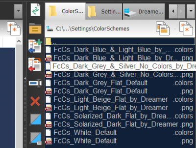

If the FC window is on the bottom right corner, it's small and the file name can't be fully shown, tooltip is partly cut off / off screen.
In Details and List view.

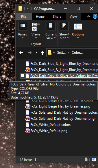

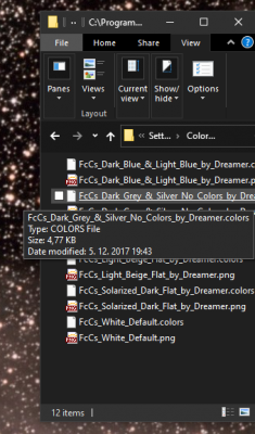

In Explorer the tooltip is moved a bit left, so it can be shown correctly.

note: in Windows Explorer it is the same, i.e. the tool tip is displayed over the UI, not within it

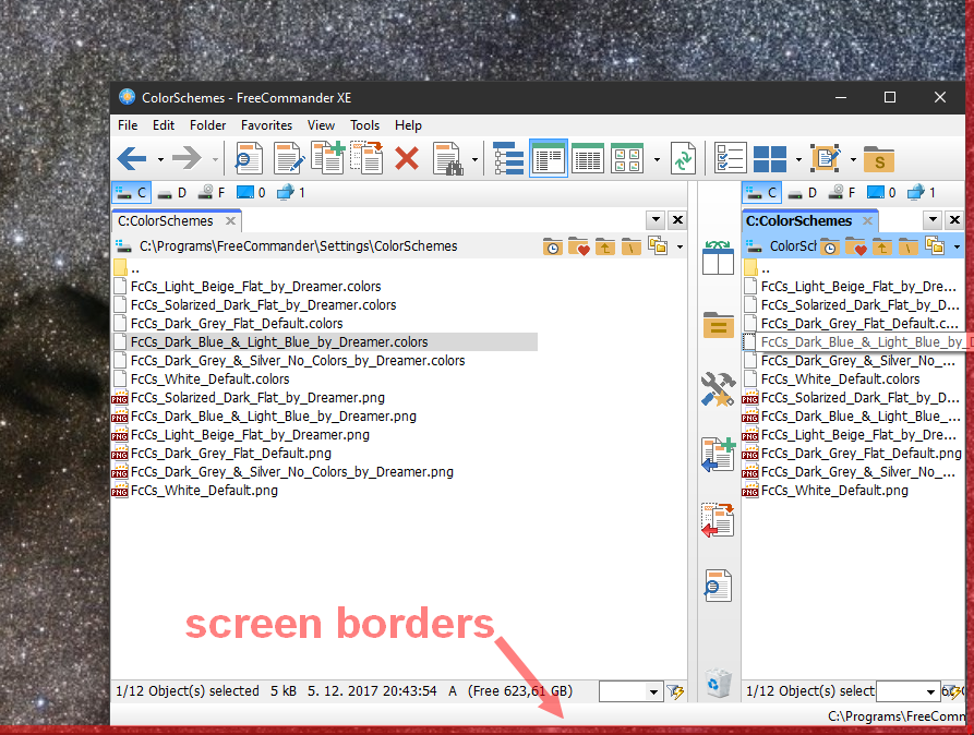

Strange, I tried with default settings, another screenshot.

In Windows explorer the tooltip is moved left to be able to be completely shown, in FC the tooltip is NOT moved left and therefore cut off.

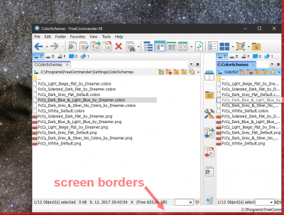

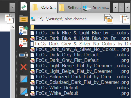

Can confirm, file name caption is not aware of screen/display boundaries. When file names are so long that at the end of the name <...> are shown and the mouse cursor is hovering over the name AND FC is moved past the borders of the screen/display/monitor the file name caption is cut off.
File Name Caption, FC fully viewable on the screen.
File Name Caption, FC moved right passed the borders of the screen (not fully viewable).
