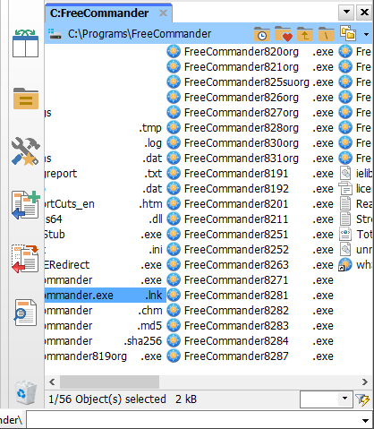

#1 Post by Dreamer » 30.10.2020, 21:57
- use NC mode
- use option "Right align extension..."
- use refresh option "Add new items at the end of the list"
- use option "Use dialog window for rename"
- focus right panel
- resize FC window to small window, e.g. 800x600
- use can use FC install folder to test, create multiple FC.exe copies, as on screenshot
- create shortcut of any file from first column
- focus the shortcut / lnk file, which is last item now
- rename this file, just remove " - Shortcut" text or similar

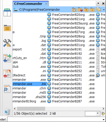

= first column in file list is broken
= last item "what_is_fcStart_ini.txt" has the wrong icon
Some steps are possibly not needed.
It's not fixed when using arrow keys up, down.
Ctrl+R fix the issue.
FC 832 donor 64-bit, Windows 10 2004 64-bit.

#2 Post by Dreamer » 04.11.2020, 23:31
The bug will be fixed in the next version (833), confirmed, thanks, Marek.
