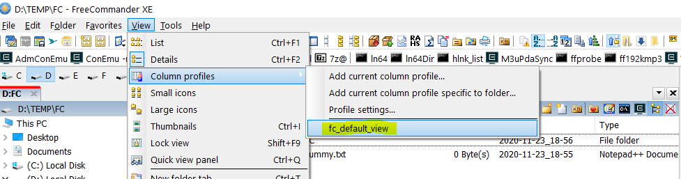

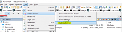

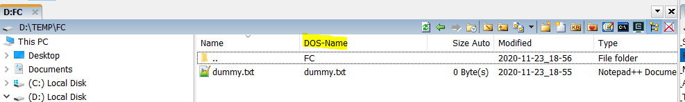

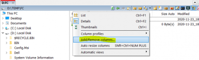

I just reset all custom views to get back to initial default FC configuration.
Then I add DOS-Name column (one I never use) :
From then on, select View > Column_profiles > fc_default_view won't change anything (although that column does not belong to my default as you will see in my config files)
I expect DOS-Name column (among others) to be replaced by fc_default_view columns right ?
Besides, I wonder what are all thosesections in my .ini file (?) could they interfer ?
[FcDetailedViews_{<UUID>}] Thanks

Re: Column profiles simply do not work anymore for me (build 832)

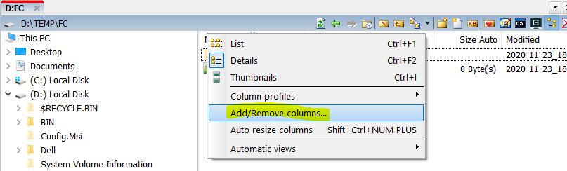

If you add some new column - the column is added to the active profile.
In your example it is "fc_default_view" profile.
If you now click on "View > Column_profiles > fc_default_view" no change is to see because you have selected exactly the same profile as currently loaded ( you have changed fc_default_view).
If you want to remove some columns from fc_default_view (e.g. DOS-Name) you can make it with Shift+F1 and "Add/remove columns".

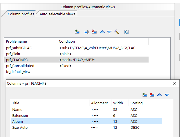

I've spotted a few intricate problems within that (precious) functionality, specifically with "Switch view mode automatically on folder change" option.

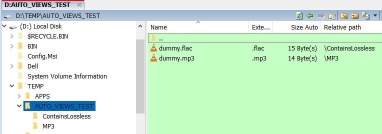

Case setup :
2 dummy files (1 flac, 1 mp3) in 2 different subdirs : I've defined a profile that works perfectly by itself when subdir containts "FLAC" or "MP3" substring : (prf_FLACMP3 has the peculiarity to show "Album" column)
...and I also have defined auto selectable views based on subdir content : (to be continued, it seems I can't attach more than 3 images event if they are very small (?))
Case setup :

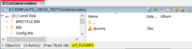

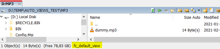

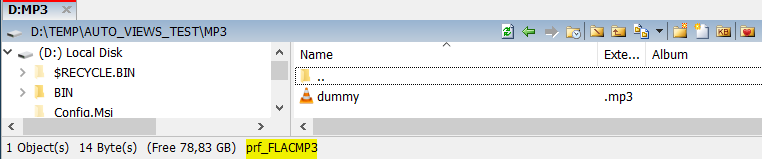

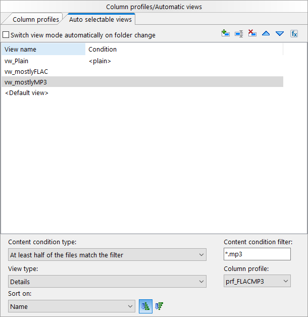

841 / NOK / Switch view mode automatically on folder change
Now (Case Scenario) :
When "Switch view mode automatically on folder change" is checked out,
entering MP3 subdir works fine because folder name is "MP3" : When "Switch view mode automatically on folder change" is checked (activated),
entering ContainsLossless subdir works fine because folder contains mostly (only) .flac files (one) :
But oddly enough when I get back to MP3 subdir, then fc_default_view is activated : ...like if having both auto-view and column profile applicable would clash in some way ?
I here attach my FreeCommander.views.ini
Thanks !
Thanks !

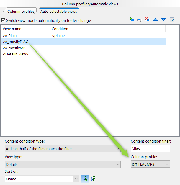

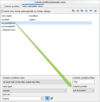

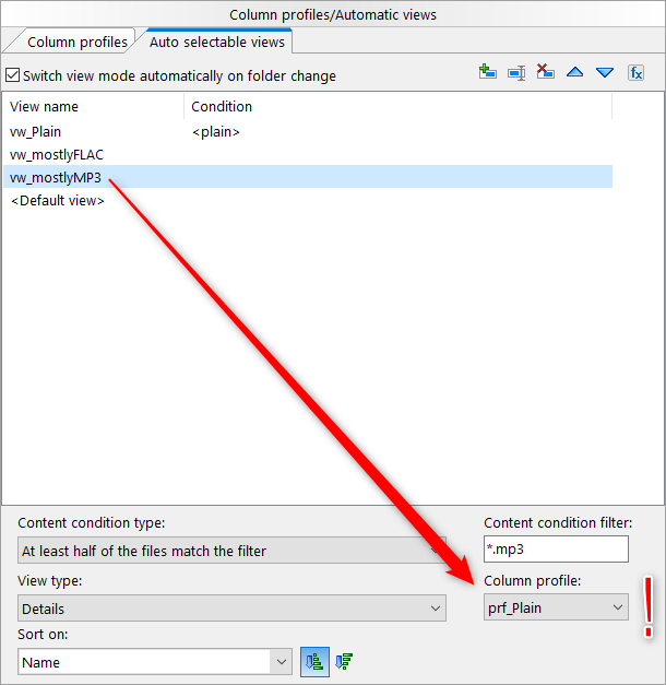

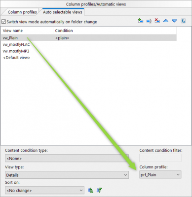

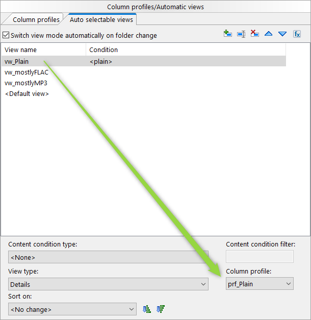

841 / Auto-views bug in column profile drop-down selector
Another weird one...
I define target column profile for <plain> condition : ...then for "mostly" .flac : ...then for "mostly" .mp3 : (to be continued...)

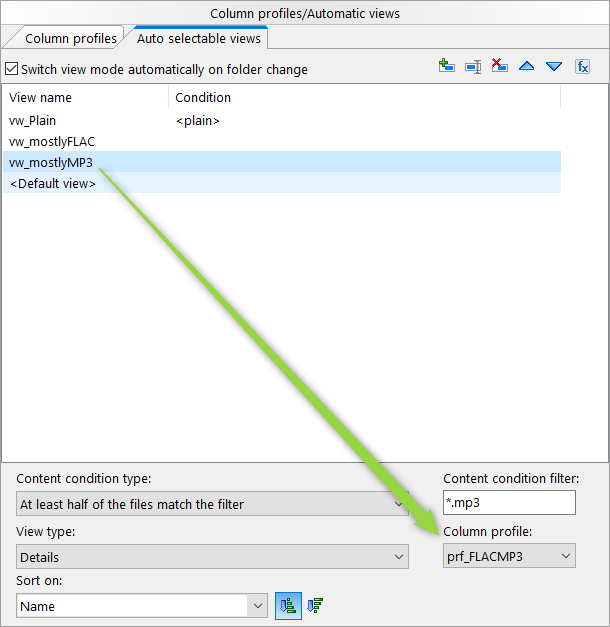

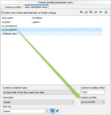

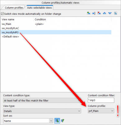

841 / Auto-views bug in column profile drop-down selector (cont'd)
...but if I get back to vw_Plain and again directly to vw_mostlyMP3 :
prf_Plain appears (visually) to be associated with vw_mostlyMP3 (!)
I here attach my FreeCommander.views.ini file.
