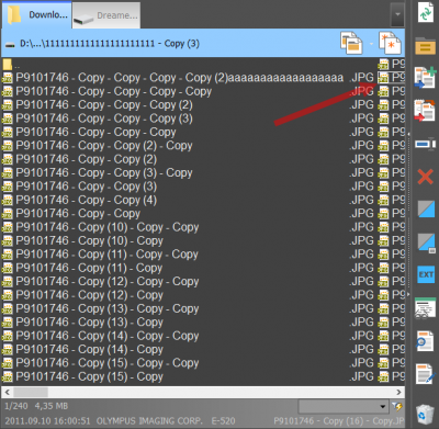

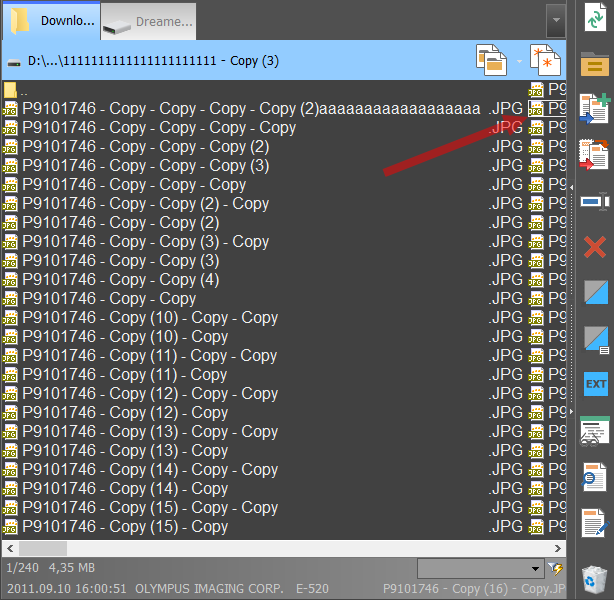

- To reproduce:
- use my setting files from previous version
- use list view and many files with the width like on the screenshot
- focus the first file
- now click the icon of the file in second column
- focus is changed to correct item in the second column, but...
= column is not changed, so the current item name is not fully visible
= column is not updated also if you click the filename in the second column, file is opened, but column is not updated, even if you close the other program, so FC is inactive and active again, you can test with jpg or txt, open it in small Notepad window
- use my settings (use list view and lock view, if needed)
- use list view and many files (300+) with the width like on the screenshot
- focus 1st item from second column, so that second column is fully visible
- now press F11
= position is wrong, first column with focused file is invisible
- press down and up arrow to focus correct file
- press F11 again to switch back to window mode
= position is wrong (as on the screenshot)
- press down and up arrow to fix view
- now maximize window (this is the same as with fullscreen)
- restore window to window mode
- press F12 and Enter
- in window mode select last 2 files
- delete these files
= position is wrong, it's at the first column, last file is focused, but it's invisible
- press up and down arrows to fix position
- now press F11 twice
= position is wrong, it's at 4th column, last item is focused, but it's invisible

Thanks, Marek, partly fixed in 8329, except these (some are different):
= focus is lost, changed to [..] item

#5 Post by Dreamer » 29.11.2020, 22:39
8329+
= position is wrong correct now, fixed in 8329+

Re: 8328 - Position issues in list view
#7 Post by Dreamer » 30.11.2020, 23:25
Fixed in 833.
Fix confirmed, thanks.
For me it is correctly.
OK, I think I got it, it works good when I click to maximize/restore button, but it's wrong if using double click to title bar to maximize/restore window.
