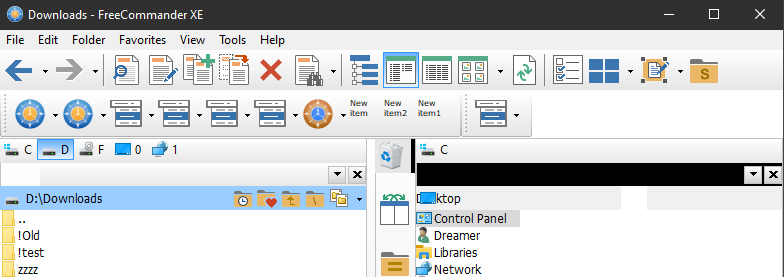

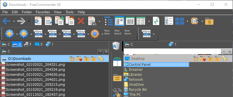

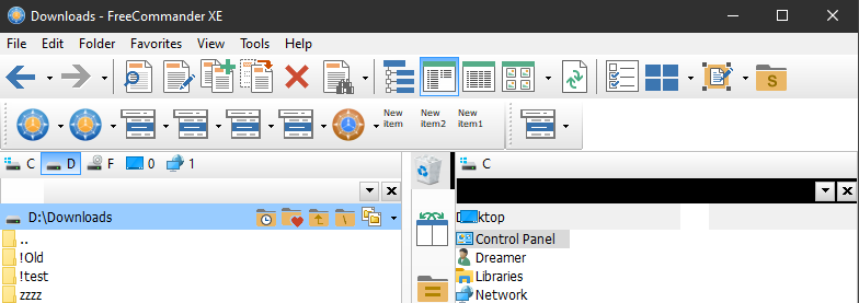

I just started FC with command line parameters for default settings, changed to dark flat default color scheme, changed quick viewer to same panel and "top", also changed FC window height a bit, then Ctrl+Q at png image multiple times.
First I had a standard Exception dialog, then I have strange wide empty window (screenshot) and then whole FC was broken, some objects were missing, after few seconds it was closed without any error dialog.
Another FC instance was running with quick viewer opened.
I'll try to reproduce it.
EDIT: I can reproduce it with default settings now, just focus png file and use Ctrl+Q to quickly open/close quick viewer, I had multiple empty windows, main FC window was broken too.
I can't reproduce it with my custom settings.
