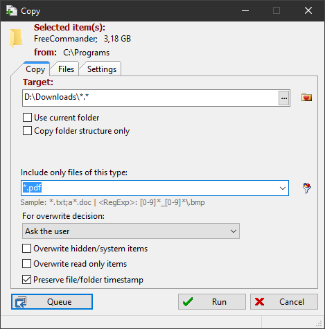

Hi,
is FC able to copy(move) files with folderstructure but within the folder structure only copy(moveI files matching a specific criteria?
Example1:
folder structure:
c:\test\test1\ contains:
1.pdf
1.doc
2.pdf
2.xlsx
c:\test\test2 contains:
1.pdf
2.pdf
3.doc
if a user wanted to copy c:\test with subfolders (test1, test2) but only copy .pdf files to D:\
target folder D\TEST would be created.
with subfolders:
d\test\test1 containing:
1.pdf
2.pdf
d:\test\2 containing:
1.pdf
2.pdf
Thanks for the help!
Copy folderstructure with file type selection
Re: Copy folderstructure with file type selection
I'm not sure if I understand, but probably like this, press F5/F6 and type *.pdf to filter field.
That worked. Thanks!Dreamer wrote: 07.03.2021, 17:26 I'm not sure if I understand, but probably like this, press F5/F6 and type *.pdf to filter field.
I had to change FC's default copy method (Tools->Settings->File/Folder operation->General->Copy)Dreamer wrote: 07.03.2021, 17:26 I'm not sure if I understand, but probably like this, press F5/F6 and type *.pdf to filter field.
It was setup as "use Windows", so I had to change it to "Use FreeCommander".
I can't remember setting this to "use Windows", is this FC's default setting? If so, why is that, and couldn't be better changed default to "Use FreeCommander" ??
mgroen wrote: 11.03.2021, 12:03If so, why is that, and couldn't be better changed default to "Use FreeCommander" ??
Do you know the Queue feature? It's very useful.Dreamer wrote: 20.07.2016, 01:31By default, for copy/move file/folder operations, "use Windows" is the default operation, why?
Anyway, it's OT here, so you can continue in this topic, perhaps also copy your posts there, you can find my opinion and also reply from Marek:
Default settings for queue and operations - FreeCommander Forum
Thanks for the info. Will copy my remarks in that topic as well.Dreamer wrote: 11.03.2021, 18:32mgroen wrote: 11.03.2021, 12:03If so, why is that, and couldn't be better changed default to "Use FreeCommander" ??Do you know the Queue feature? It's very useful.Dreamer wrote: 20.07.2016, 01:31By default, for copy/move file/folder operations, "use Windows" is the default operation, why?
