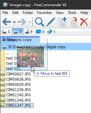

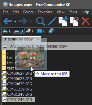

#10 Post by Dreamer » 12.03.2022, 18:31
Please try the latest version 866 and test with the portable version, your custom settings will be preserved.
https://freecommander.com/en/faq-freeco ... l-portable
I'm not sure what you mean by "tooltip with the folder option"
fc Drag & Drop Destination Highlight_1.png (45.48 KiB) Viewed 515963 times
fc Drag & Drop Destination Highlight_2.png (43.85 KiB) Viewed 515963 times
BTW What is your OS?
