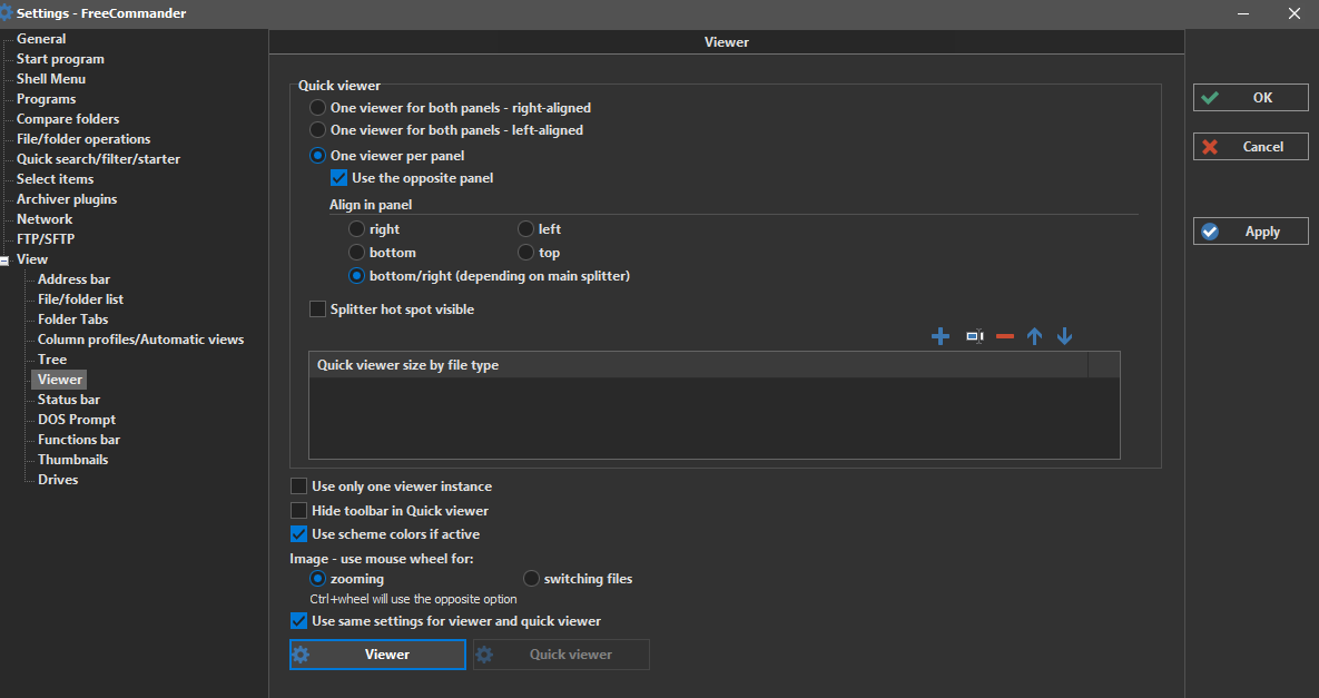

You should set the Viewer to
"One viewer per panel"
"Use the opposite panel"
like this

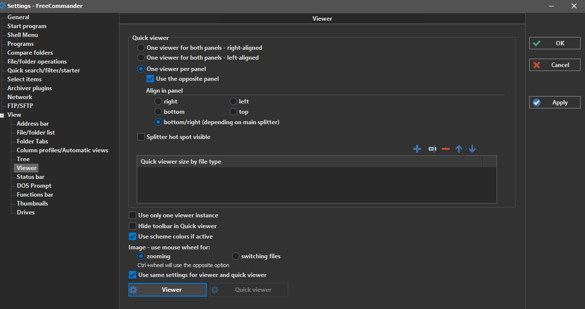

like this
