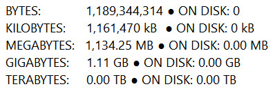

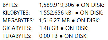

but when I hover mouse pointer over my Status Bar I only get to see something like this for files
Status Bar - file.png (130.46 KiB) Viewed 239098 times

When I press the ALT + F9 shortcut [i.e. turn on calculating of sizes of items] info displayed for files will not change and for folders it will be shown like this
Status Bar - folder with calculation.png (149.76 KiB) Viewed 239098 times
Please note here the apparent difference between showing nothing at all after
ON DISK:
and showing e.g.
ON DISK: 0.00 MB

In Build 946 64-bit Donor Portable and Build 941 32-bit Public Installed when using at
Tools > Settings > View > Status Bar > Content > Define Details > Hint Pattern
e.g.
 BYTES:             [fc_sizeSel] B ● ON DISK: [fc_sizeOnDiskSel] B
 KILOBYTES:      [fc_sizeKBSel] ● ON DISK: [fc_sizeOnDiskKBSel]
 MEGABYTES:   [fc_sizeMBSel] ● ON DISK: [fc_sizeOnDiskMBSel]
 GIGABYTES:     [fc_sizeGBSel] ● ON DISK: [fc_sizeOnDiskTBSel]
 TERABYTES:     [fc_sizeTBSel] ● ON DISK: [fc_sizeOnDiskGBSel]
I still get to see for a file
size on disk.png (8.38 KiB) Viewed 225587 times
i.e. the OnDisk size counts do not work - even if I will turn on the
Tools > Settings > View > Column profiles / Automatic views / Auto selectable views > Show size of folders > Active
for a particular Auto Selectable View
