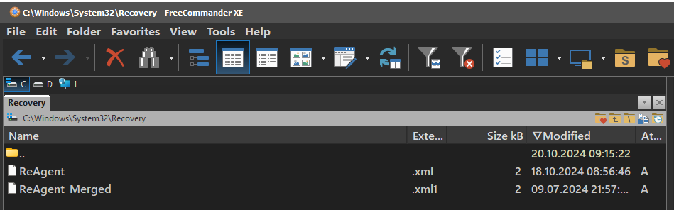

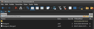

Dear all,
the following bug occurs with FreeCommander XE 2020 public 32-bit as well as FreeCommander XE 2024 public 32-bit. I did not test versions before 2020 or versions between 2020 and 2024, but assume that all versions beginning with 2020 (and probably earlier) are affected.
So I am running FC XE 2024 public 32-bit on Windows 10 Enterprise 22H2 with all updates installed that were available at the time of writing. FC is showing the wrong contents in the directory
C:\Windows\System32\Recovery
Please have a look at the attached screenshots. The first one is from Windows Explorer which lists the correct contents. The second one is from the Windows command prompt where the "dir" command also outputs the correct contents; the second screenshot also shows that there is nothing special with the attributes of the files in that directory. The third screenshot is from FC which lists the wrong contents.
As we can see, FC does not list the file "ReAgent_Merged.xml1" which definitely exists (I can open it with any text editor using Windows explorer, change it and save it), and lists the file "Winre.wim" which definitely does not exist.
Any ideas?

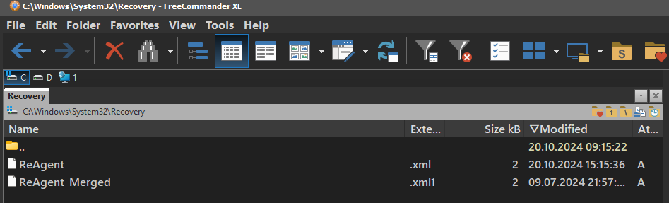

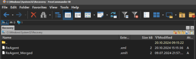

#2 Post by horst.epp » 20.10.2024, 11:22
Not confirmed

Thank you very much for trying to reproduce. However, it's still different for me.
Additionally, I have reproduced the problem using FreeCommander Portable (as recommended in the first sticky post in this sub-forum). The portable version also lists the non-existent "Winre.wim" file and does not list the existent "ReAgent_Merged.xml1" file.
I also have run "sfc /scannow" and "chkdsk c:". In both cases, no problems have been reported.
I am quite sure that the problem is due to a bug in FreeCommander, not due to a corrupted file system, because 1) file system tools did not report any error, and because 2) Windows Explorer lists the files in that folder correctly. I believe that with the current settings in Windows Explorer and in FreeCommander (both are configured to always show every file, including hidden and system files), FreeCommander always should show exactly the same files as Windows Explorer. At least, unless I am moronic enough to have an active filter somewhere that I forgot about. But even then, this wouldn't explain why FreeCommander is listing a file that definitely does not exist.
Is there some sort of caching in FreeCommander that survives Ctrl+R? If yes, can I turn it off?

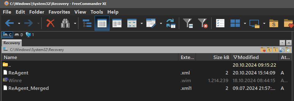

Would you mind conducting a further test? For this test, you would need to have a Windows recovery partition on your disk. The test works as follows:
- Open a command prompt with administrative permissions and issue the following command: "reagentc /disable".
- This makes the file "Winre.wim" appear in the directory in question, and FreeCommander should list it if you have configured it to list hidden and system files.
- Issue the following command: "reagentc /enable".
- This restores the original situation and makes "Winre.wim" disappear again from that directory.
- The thrilling question is if FreeCommander nevertheless still lists "Winre.wim" in that directory.

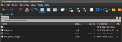

I tried your scenario.
No problem with FC.
It works perfect here under Windows 11 24H2.
The screenshots show the FC display after disabling and after enable it again.
