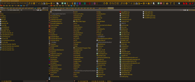

I have just tried out the x64 920 Donor version- and it seems to be unable to stick to alphabetical sort order when I navigate through folders i.e. every time I enter another one it is somehow messed up
I had no such problem with the so far used Build 912 64-bit Donor Portable & Build 901 32-bit Public Installed on my Windows 10 Enterprise 20H2 x64 [10.0.19042]

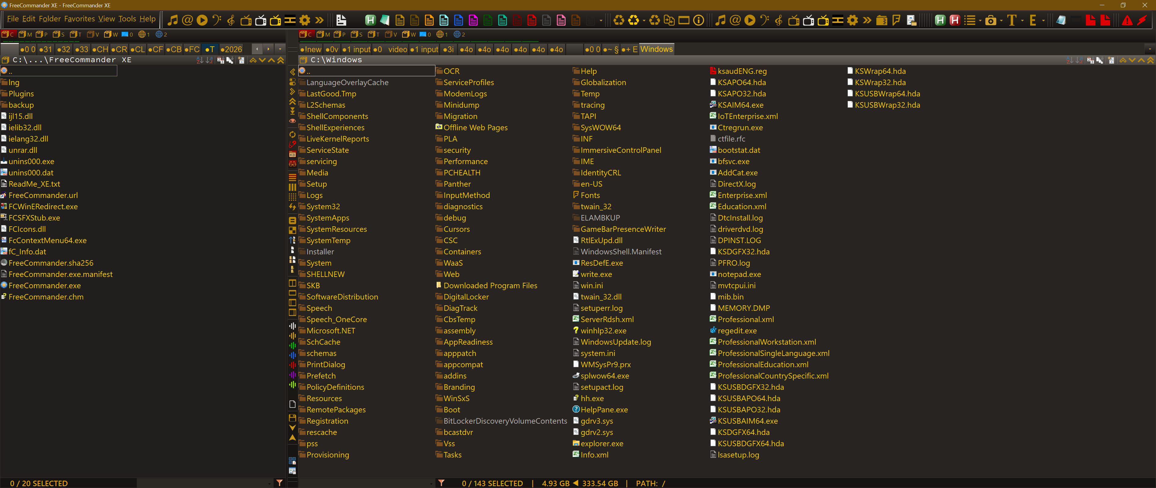

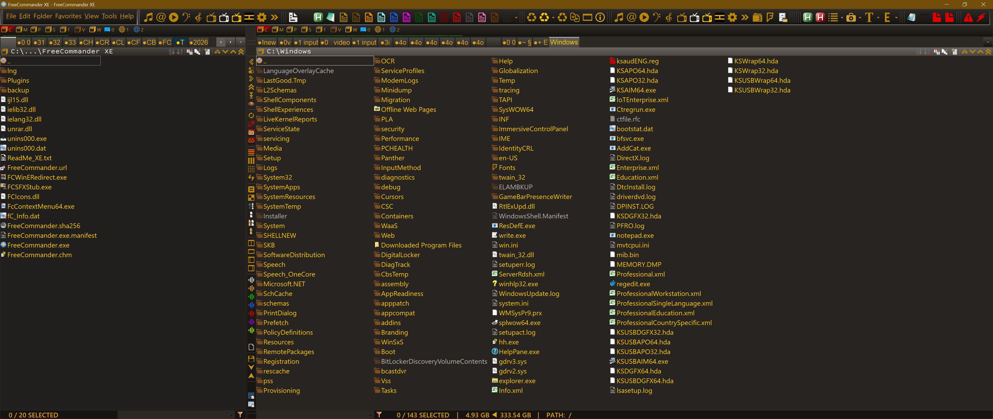

The below screenshot shows two explanatory well known folders affected by this unwanted switch of sort order
I see no pattern in the above order - and I can assure you that it is not an order that uses data from any of these three Columns [which I sometimes use]:
