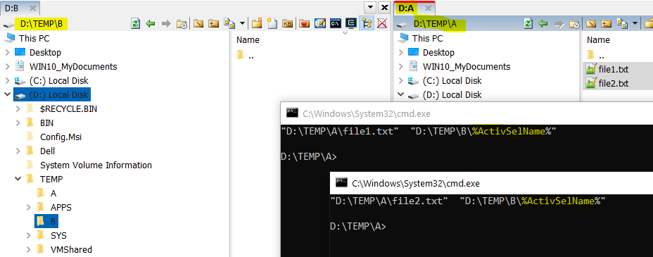

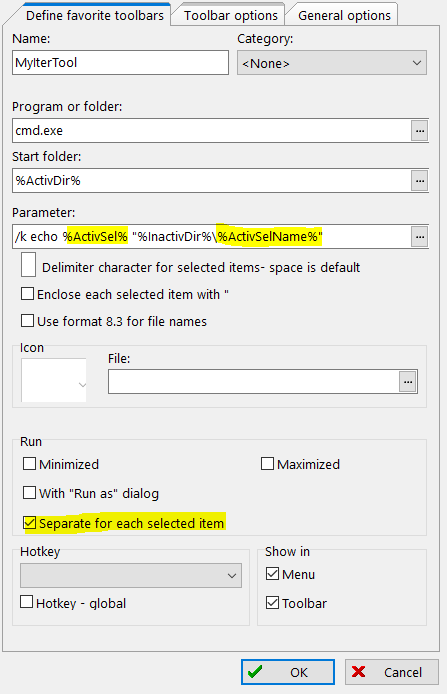

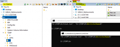

Let me clarify with a case :
As I defined MyIterTool which is my iterator favorite/custom tool (Program => cmd.exe ; Parameter => /k echo %ActivSel% "%InactivDir%\%ActivSelName%") :
%ActiveSel% will indeed iterate each selected file in active folder (here A) in a separate cmd.exe shell...
...but target %ActiveSelName% will NOT in turn be interpolated into the current file name (here prefixed with %InactiveDir% which is expanded all right although not expected to vary) :
What I would expect would simply be those two cmd.exe shell yes, but with the following respective content :
"D:\TEMP\A\file1.txt" "D:\TEMP\B\file1.txt"
"D:\TEMP\A\file2.txt" "D:\TEMP\B\file2.txt"
Does it make sense ?

#7 Post by kino » 26.01.2021, 15:42
Just right like in FreeCommander XE 2021 Build 841 64-bit donor
Thanks !!!

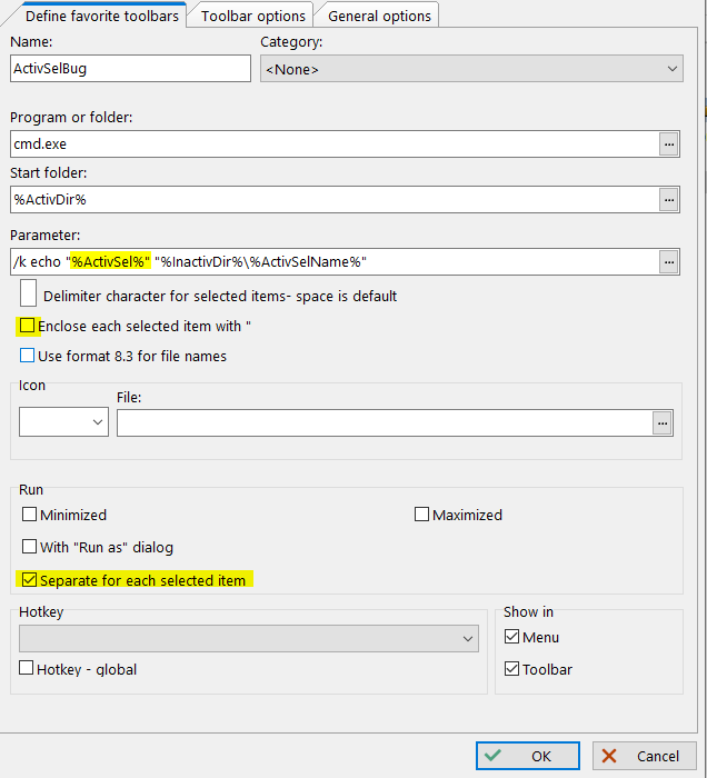

846 : %ActivSel% yielding an extra pair of " (+<space>)
#9 Post by kino » 07.05.2021, 14:34
Hello Marek, Dreamer, (and other resourceful FC developer heros ;),
I think we have a little bug (fortunately work-around-able) with this very functionality so I'm not opening a separate thread.
(in my setup, I have my_file1.txt in both D:\TEMP and D:\TEMP\quoted_ActiveSel_bug ; I use this dual pane tools a lot since Separate for each works well with Sels)
Basically, %ActivSel% place holder seems to generate arbitrary double-quotes characters around actual values at intrapolation-time, without "Enclose each selected item" option :
...yields :
""D:\TEMP\quoted_ActiveSel_bug\my_file1.txt" " "D:\TEMP\my_file1.txt"
whereas :
/k echo "%ActivDir%\%ActivSelName%" "%InactivDir%\%ActivSelName%"
...will yield as expected :
"D:\TEMP\quoted_ActiveSel_bug\my_file1.txt" "D:\TEMP\my_file1.txt"
  • So this is my work-around for now but can you confirm "%ActivDir%\%ActivSelName%" and "%ActivSel%" are virtually the same ?
  • What about that extract " enclosing (with an extra space before ending as you can see)
K (using Build 846 64-bit donor by now)
