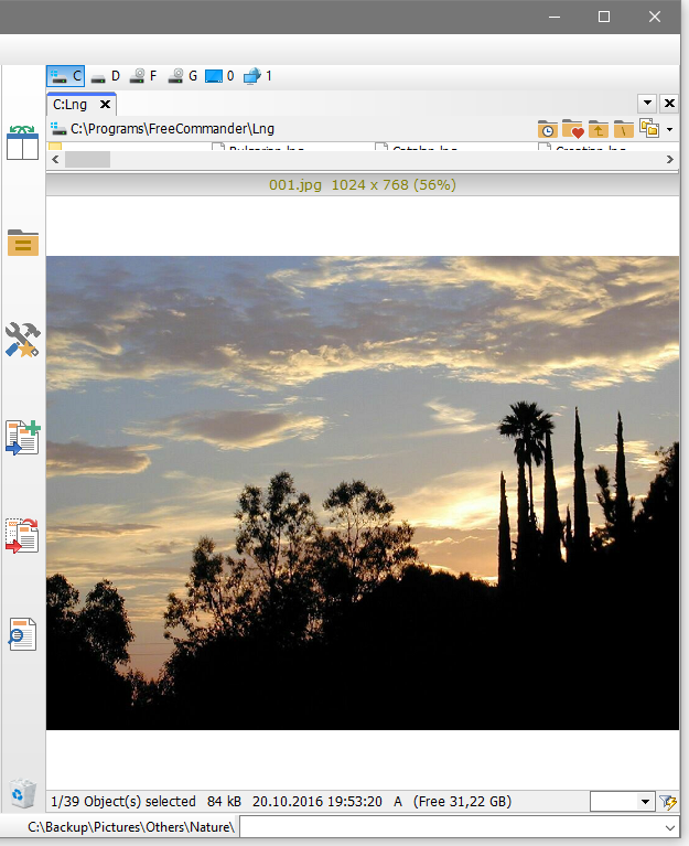

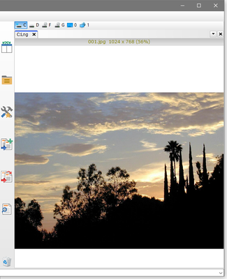

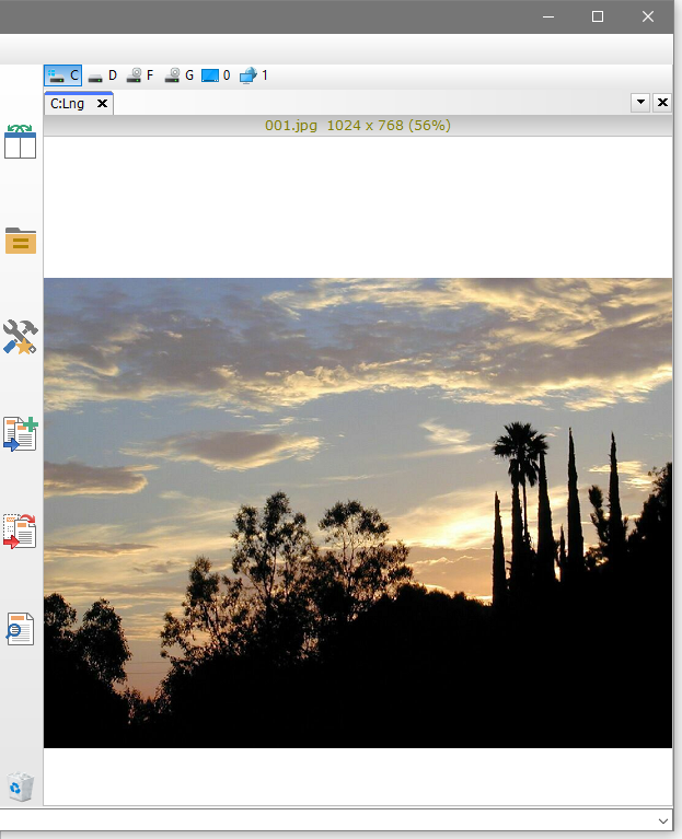

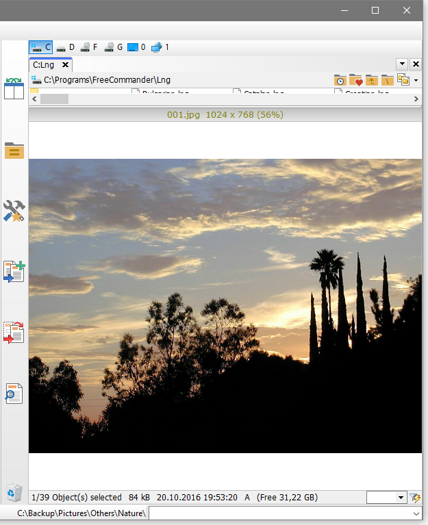

#1 Post by Dreamer » 26.11.2016, 17:07
- use folder with images
- activate the quick vewer - Ctrl+Q
- in settings (F12) - view - viewer, use option "Align in panel" - "top" and click OK
= quick view position is not changed, even after FC restart
- use option "Align in panel" - "top" and click the Apply button, then OK
= still doesn't work, position is not changed
- use option "Align in panel" - "bottom", click Apply, then use "top" and click Apply and OK
- from now on it works even without Apply, just with OK, weird
- maximize FC or go to fullscreen (F11)
- enlarge the quick vewer size using the splitter to about 90%
- it's possible to enlarge it even to 100%, while the splitter to change the QV size is still available
- now switch back to normal window size
= file list panel, status bar, and the quick viewer splitter to change size is invisible, so it's impossible to resize quick viewer size to view the file list
- to view the file list it's possible to go back to maximized view/fullscreen, resize the QV size and go back, or...
- press Ctrl+Q twice
- now the file list is visible and the the viewer size is about 90% in window view
- go to fullscreen or maximize view
= quick viewer size is just about 50%
- in settings (F12) - view - viewer, use option "Align in panel" - "bottom" and click OK
- now follow the same steps as above
= now the file list, status bar, and splitter is visible, somehow, but the result is not good either
I think the best way to solve/fix all these issues it to use two (or three) different quick viewer sizes - 1 for window view, 1 for maximize view / fullscreen
